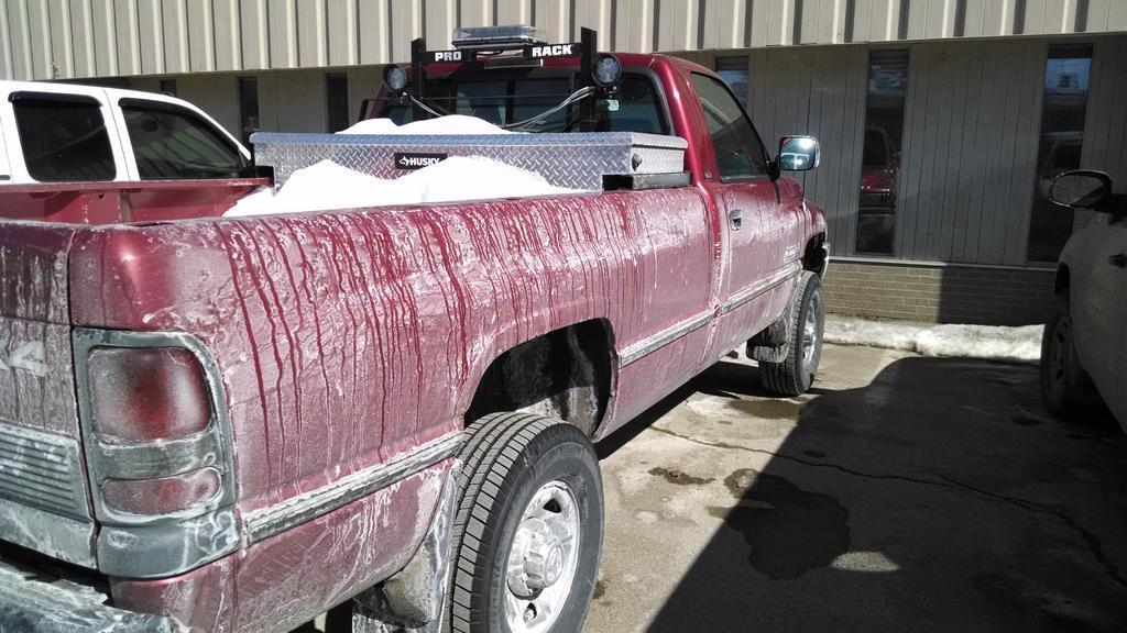

This weeks build up of road chemicals....and it ain't over yet..
They started using that crap in PA and NJ before I got out of there. Nasty stuff, and generally takes more than one washing to get it off. If there wasn't much precip it would make the roads so slimey it was more slippery than the damn snow. There was a Warren County Road Dept shop right up the road from our store, and they had a spray boom they drove under to apply that crap to the loaded spreader trucks IIRC.
There is a product plow jockeys use to try to hold corrosion at bay. It's called Sulfamic acid. It's availeable at Home Depot. It's primary use is cleaning tile that has just been installed. When used at half strength it doesn't seem to harm paint or trim. Put on with a garden sprayer and washed off with a garden hose. I'll be doing a cleanup with it next month.
It hurts my eyes to see a vehicle in that salty condition.
I have been lucky this year and haven't had to use the pickup truck. It has sat in the garage since February 1st. I sacrifice the eco-box car to the salt as it is a lot cheaper to replace and fix than the truck.

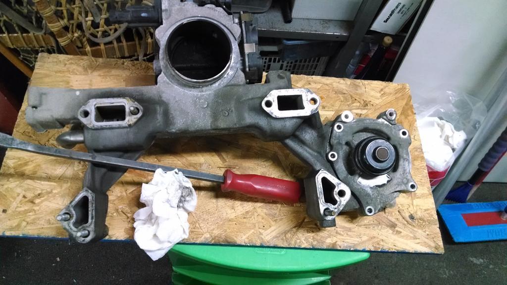

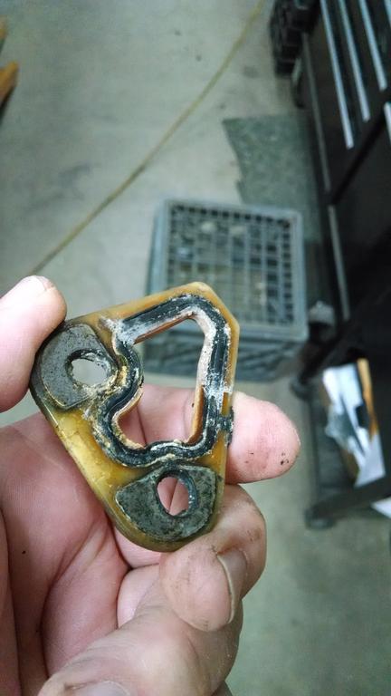

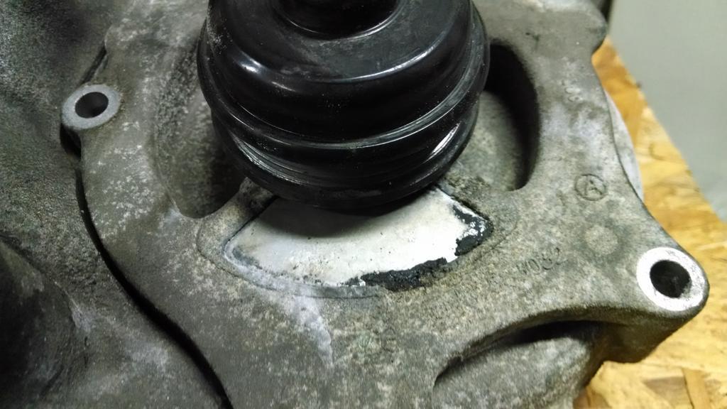

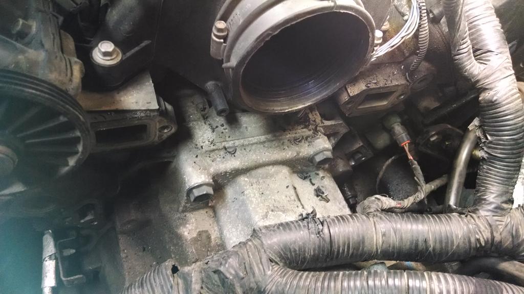

Wasn't a waste of time or money, note trail under pulley. Also decided that the gaskets were about cooked as well.
$1000.00 plus at a Caddy dealer, I'll shed some blood instead. And they would not be as careful as I am regarding pinched wires, etc..

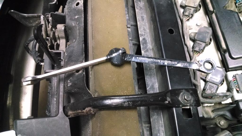

What you do when you just can't get the rear lower rat ba***rd bolts tight...
Double wrench and 33+ black tape....
Mike,
You're making a VW TDI timing belt job look down right pleasant.
Designed by a committee with different measuring standard?
