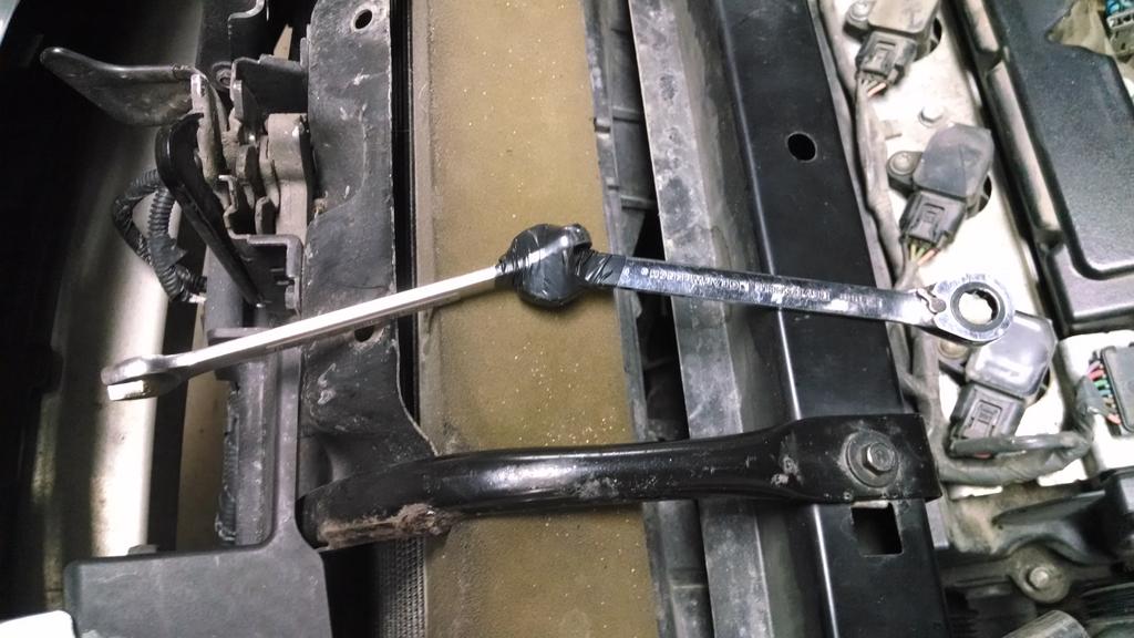

What you do when you just can't get the rear lower rat ba***rd bolts tight...
Double wrench and 33+ black tape....
I have several old wrenches (duplicates) that I have needed to do something similar with. I simply cut the open end off with a deli wheel so I can slip a chunk of heavy wall conduit over. One end is slightly mushroomed to accommodate larger wrenches. Works well.

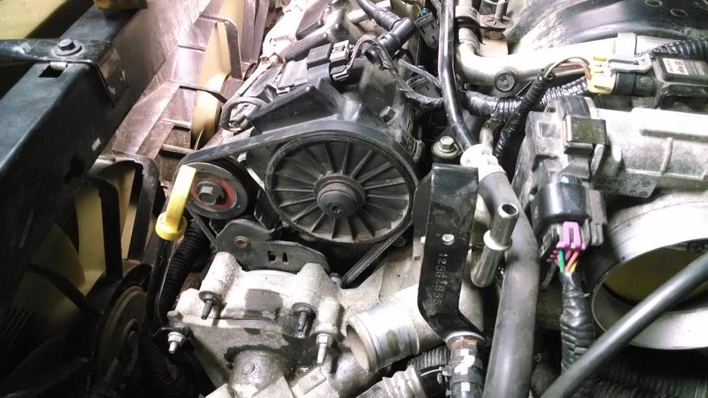

Back together. No apparent leaks. I will know for sure in the morning.
Water pump has its own belt and little bitty tensioner..
What a project, Mike. The last two water pumps I did were my '05 CTD, and recently a 351W in an old F-350. Both were a piece of cake. Serviceability seems to be slipping lower and lower on the totem pole of engineering priority on most stuff.

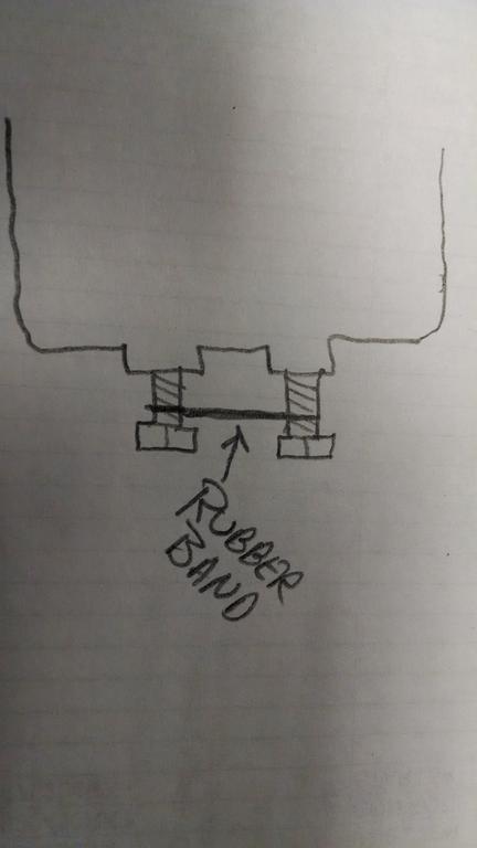

I meant to get a picture of it before I put it back in. The lower 4 bolts and one of the upper bolts HAVE TO go in with the manifold as there is no room to put them in afterwards. So it goes in with all gaskets on and bolts in place. Best tip that I found was to use rubber bands around each pair of bolts to hold them. That's what I did and it worked well.

Mike this is a first I have heard of rubber bands to hold bolts, do you have any pictures of this step. I think I can see it in my mind but would like to see picture if you have one.

Bolts can't fall out, gasket stays in place on the back side. Cut the rubber bands after I got the manifold in place and all of the bolts started into the block.

Mike thanks for the picture (Picasso drawing) I can see what you did now and know that I will be using that trick in the future. If I can find a rubber band when I need one.
