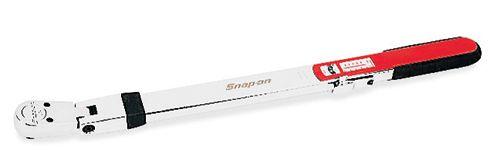

They look good. The only thing I would like to add is to consider a flex head model.
I have a top of the line Snap On 1/2" drive torque wrench that I invested in many years ago figuring it would last me a lifetime. Many times I found something in the way of the handle when trying to torque brake caliper brackets and such. Talked to Snap On dealer and he had a refurbed 1/2" drive click style with a flex head someone had traded in. I bought it.
Pretty much the only one that I use now. It doesn't swing very far but usually just enough to clear whatever happens to be in the way....just thought I would toss that out there...
Just like this one...
