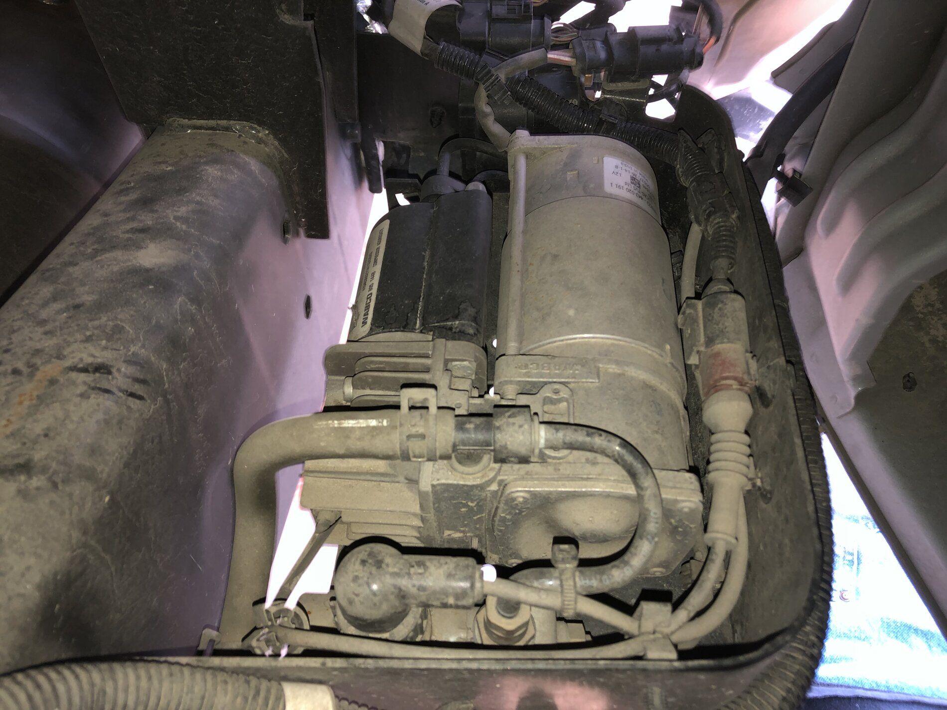

If your sure that it is running and not changing modes then you have a small leak. The dealer can put it into plant mode and test it for leaks.
It's not that it randomly comes on, but you will see and hear it adjust the suspension height. It will stop adding air to the bags and then start the compressor. If the system were closed this wouldn't happen. Instead, after it feeds the bags with the reservoir it then uses the compressor to refill the reservoir with air from the atmospehere.
It will also occasionally do it's high pressure purge after startup and then run the compressor, as the high pressure purge must put the tank below the cut-in pressure.
I am confident that I don't have any leaks, as Dad's 17 operates identically to mine. No faults, no codes, no issues... just once confusing blerb and dealerships calling it closed.
I am also confident that it's not a closed system in the normal sense of closed system, as it does not operate like one on either of our trucks. It uses the high pressure stored air in the reservoir to fill the bags when more air is needed, it then refills the reservoir with the compressor. It's very obvious that it's doing this if you watch and listen as it inflates the bags. I also have not ever noticed the compressor running when it deflates the bags to move the bag air into the reservoir, but I also haven't noticed it doing a high pressure purge to deflate the bags. I'll pay more attention to this soon.
