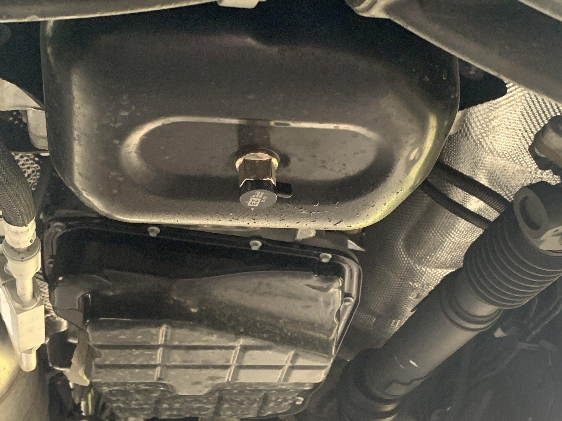

You'd have about just as much luck winning Powerball thinking a rock or stick is going to actuate the valve. For starters... The lever is on the backside of the valve (facing rearwards) you have to push the lever towards the front of the truck then downwards to open it. But then it has a cap with an o-ring on it that you have to remove before it would drain. It's a perfect fix to a wrist dripping with oil OR fishing the drain plug out of the oil bin. It's fairly well protected as it's higher than the front axle.
Here's mine....
Here's mine....
As mentioned earlier actuating the valve isn’t a concern, it’s ripping it off that is a major concern. The oil pan on these trucks is unprotected and exposed enough as it is, I’m not putting something on it that will increase the vulnerability of it. The oil pan itself is barely higher than the axle, so something hanging an inch or so lower is that much more exposed.
My wrist doesn’t get covered in oil, nor do I have to fish the plug out of the pan. o_O
For many people it’s not an issue, but get off the paved road and it’s simply not worth the perceived benefit... even on the road I don’t think it’s worth it as it likely threads in past the threads and allows for even less oil to drain out.
Paved road is bad enough alone: alligators (big rig tire caps) are enough to leave skid marks on the skid plates at times. The now dead deer coming out from under the big rig ahead of us, well, that going under the truck broke the DPF sensors (steel pipes) out of our 08 Duramax exhaust. Fixed it after our load was delivered.
I wasn’t even thinking about how low the sump of our pans lay and with the drain at the bottom of that. This makes the valve a double negative to me in this application.
Being a fleet mechanic who’s been around very diverse equipment, I’ve actually seen this fumoto type drain used on industrial equipment, so I don’t question its quality, but in my contact with thousands of pieces of equipment, I’ve never seen a crankcase or any other oil compartment “open” to the ground. There’s always been a plug or otherwise, a cap at the end.

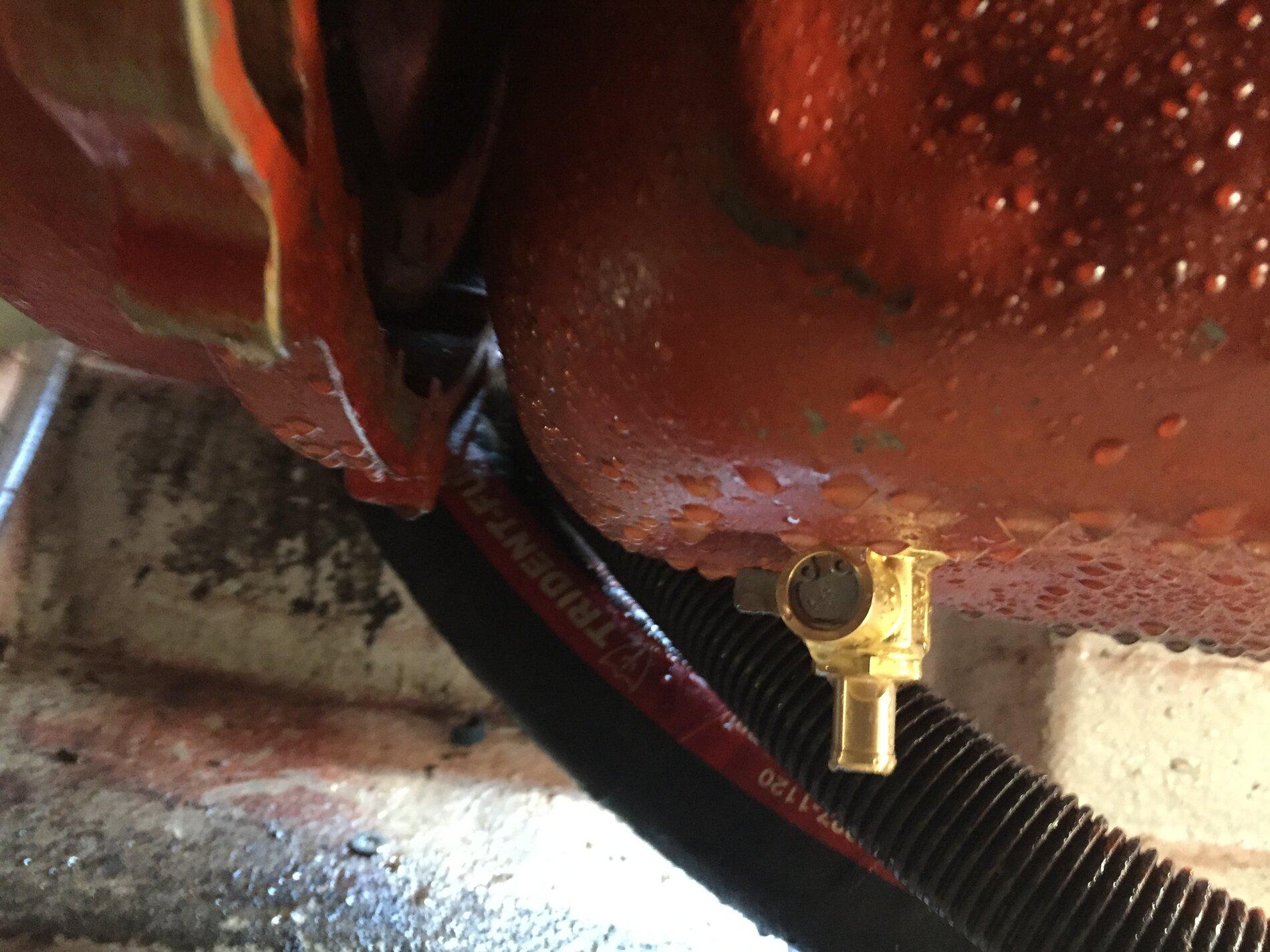

The pan leaves plenty of old oil in it already. I have heard these valves make it hold more. I have no issue unscrewing a drain plug and re installing it.
I do have the Fumoto on the 350 in my boat. I get more oil out this way than trying to suck it out. Simply slip on the hose and poke it out the stern drain hole into a waiting receptacle.
