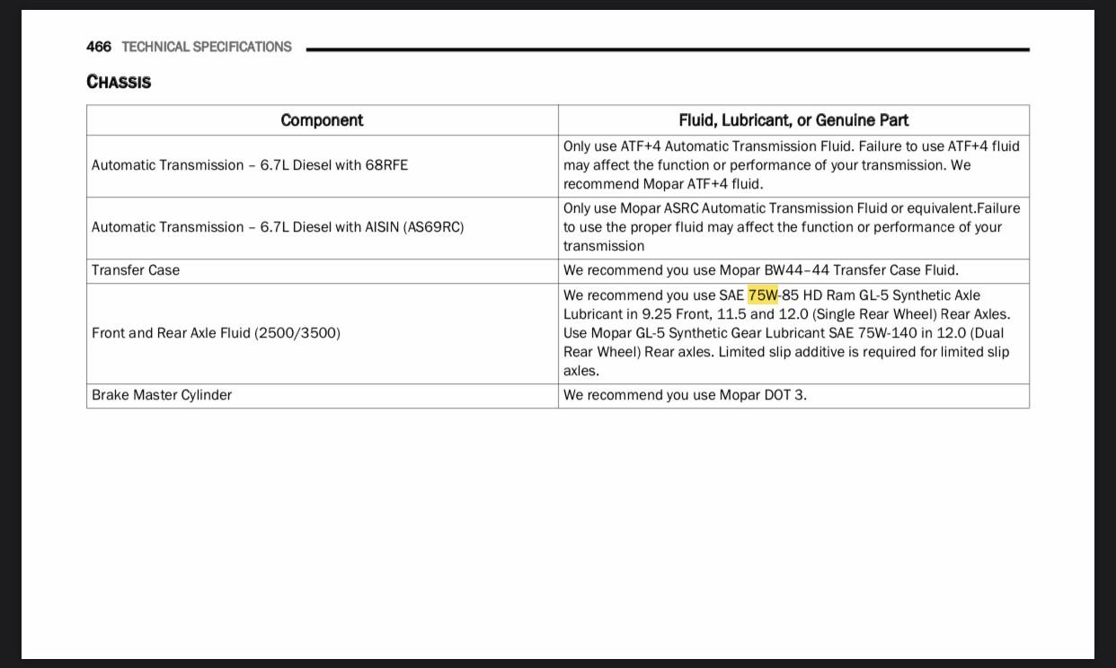

As I approach my 20K oil change, I am planning to also do the diffs. Haven't decided between Red Line or Amsoil. Anyway, I was perusing the owner's manual, and the diesel supplement, and, unless I missed it(quite possible), the capacities are not listed. It calls out 75W85 Front, and 75W140 Rear. IIRC, I'll need 3 Qts Front and 5 Qts Rear. This truck has the 12" rear diff.

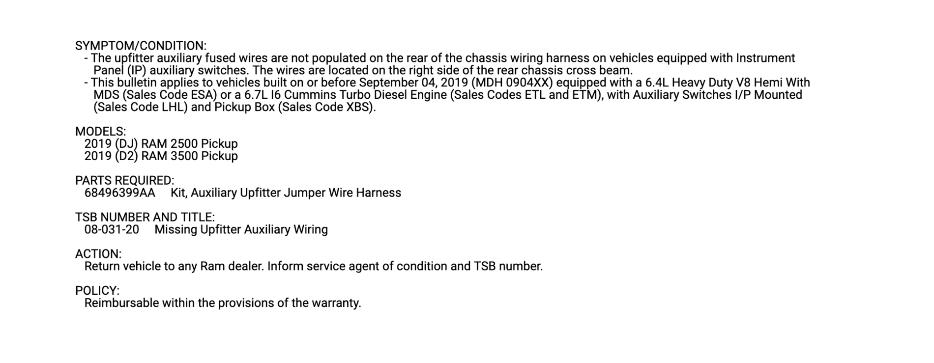

My search for better info led me to the Ram Bodybuilder site, and there I discovered there is a TSB to address a build issue I found my truck has, which is the "blunt cut wires" to the rear of the frame, a part of the upfitter switch package, were left out on earlier builds, and they apparently have a patch harness to remedy this. I had discovered this when I tried to wire up the repeater for my trailer TPMS, like I had on my '15, but couldn't locate the wires. An email reply from the upfitter group explained the error, and I figured that was the end of that.

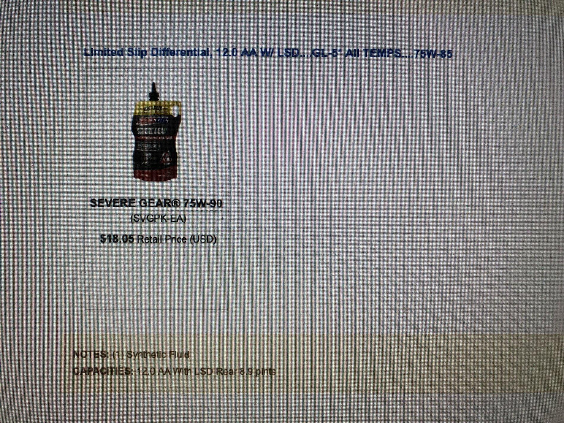

Amsoil has nifty squeeze packages now that make putting lube in easy.
It also appears that the 12.0 also takes LSD additive, the first time on a HD axle, not C&C, since 2002.
I wonder what changed. I hope it’s not a clutch style LSD again.
EDIT: For 2020 the SRW's are back to 75w-85.
Gross... I hate those. They work when you don't want them to.. i.e. on ice, and don't work when you want them to.. i.e. loose surfaces, mud, dirt, etc.
I'd rather run an open diff than a clutch style LSD.
I don't know about AAM but on the Dana's, the open axle carrier is soft and the ring gear side carrier bearing will spin. This don't happen on the LSD, the metal is way better, they also use 4 spider gears v/s 2. Maybe Tom can take pictures when he does his service. I am a fan of heavy rear axle gear oil, the Cummins needs it. 75w-85 is about like 50w, what are they thinking??

The AAM 11.5, which includes the 11.8, was designed around 75w-90. I spoke with AAM about it and they stated it was the appropriate fluid for all conditions, with the only exception (more of a joke) was constant operation in death valley well above GCWR.
AAM's have used a helicar gear style LSD since they went into a Dodge/Ram which operates better than a clutch style and doesn't require any friction modifier.
I'd be curious what all has changed with the 12.0.

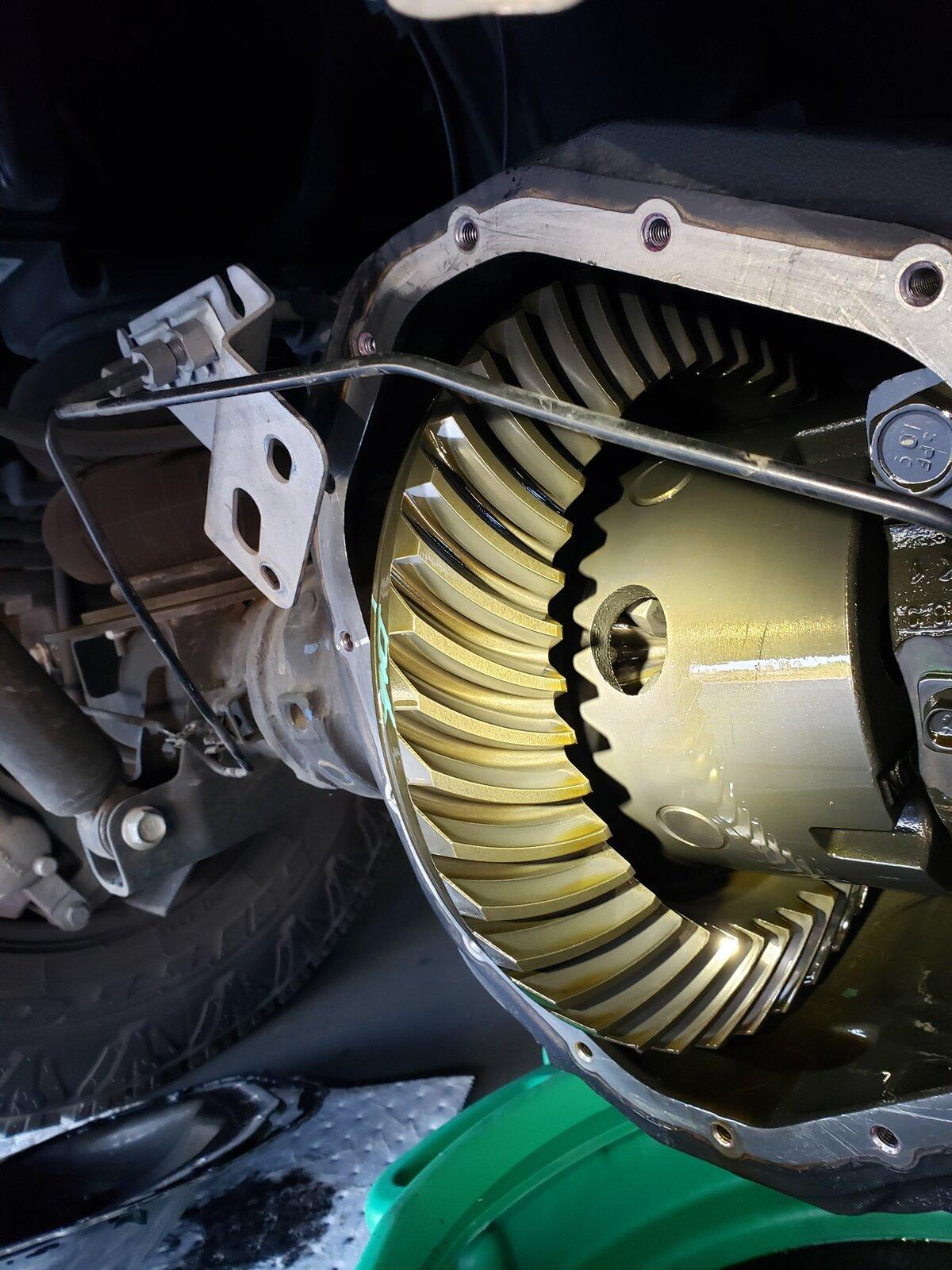

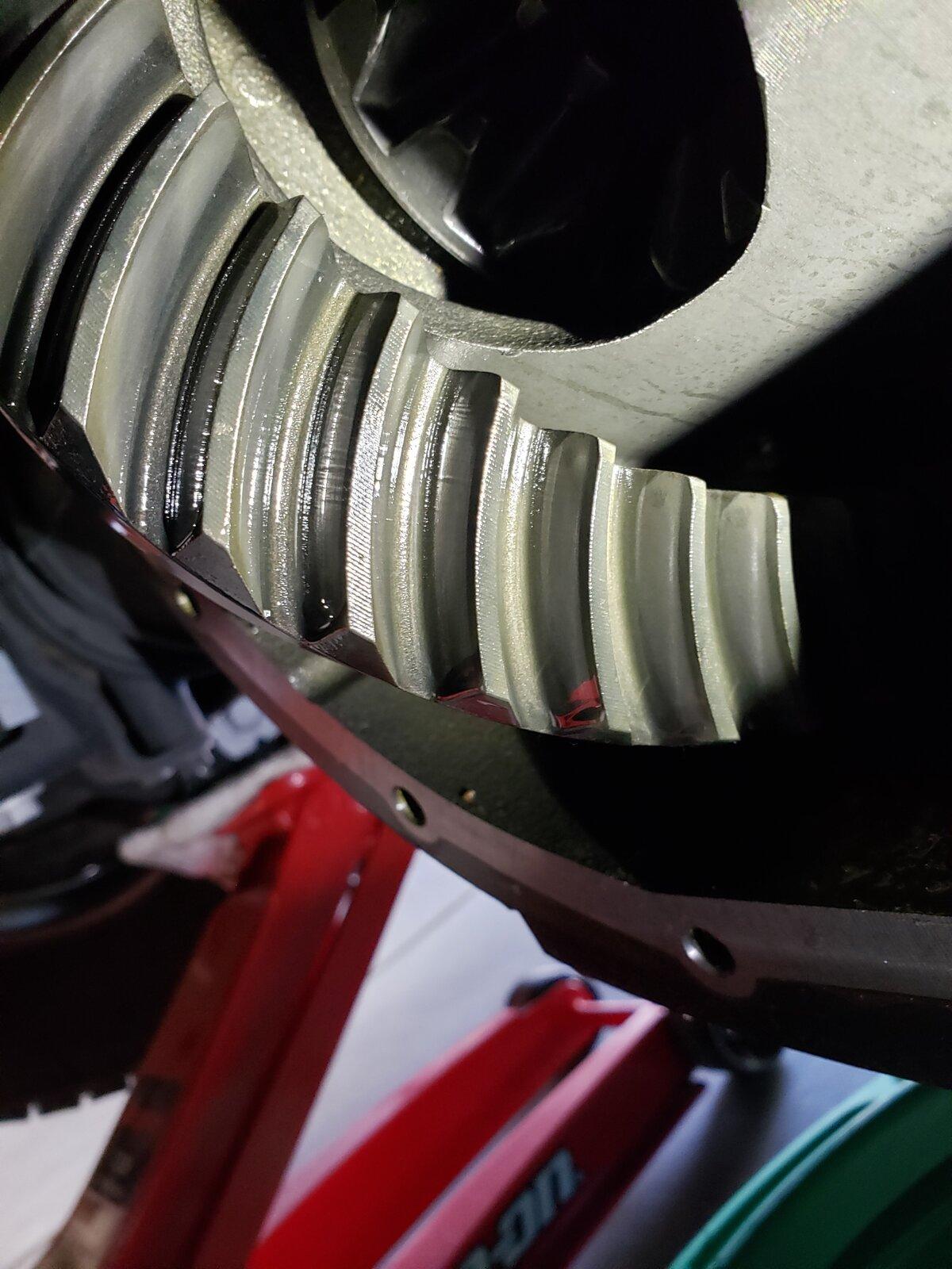

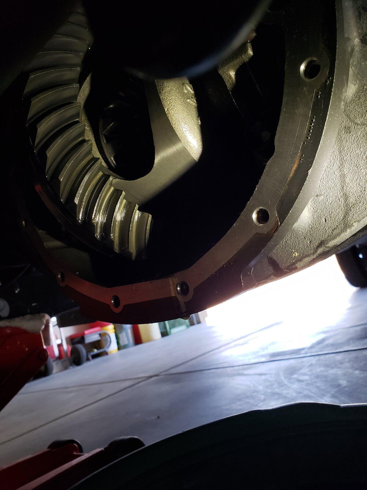

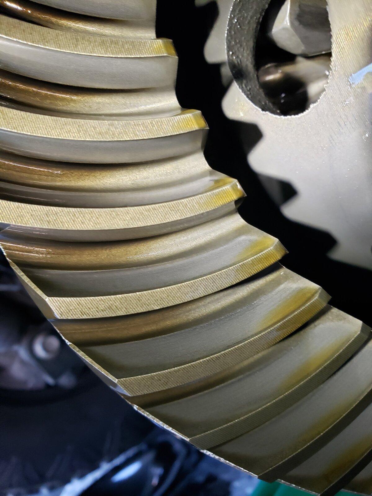

Reached 20K miles, now. Three gallons of Delo Synthetic and a Stratapore went in. Also decided to dump the diffs, based on reports on TDR. I went with Red Line 75W90 front, and 75W140 rear.
Rear was not nearly as nasty as some I have seen photos of. Maybe the 12" diff is not as hard on lube??? Pattern looked good to me. No doubt due to breaking it in by pulling the toy hauler right out of the box:D
Not surprisingly, the oil that came out of the front looked like new.
Working off a creeper is a chore these days. Gonna get that shop built one of these days.
