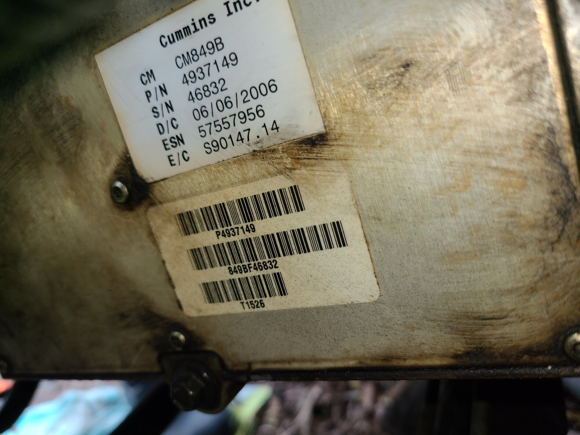

1more question just to be sure will the ecu off the 2 wheel drive work on my 4x4 or would it need reprogrammed. If the one I have don't work out. Pic is the 2 wheel drive truck I found.
The VIN would need to be programmed. But from the picture above you have the factory ECM from your truck already on the engine, just combined with the wrong harness.
If it wasn't compromised through the wrong harness connected it should start working once the harness and associated parts are exchanged.
But it's always good to have a spare at hand if needed.
