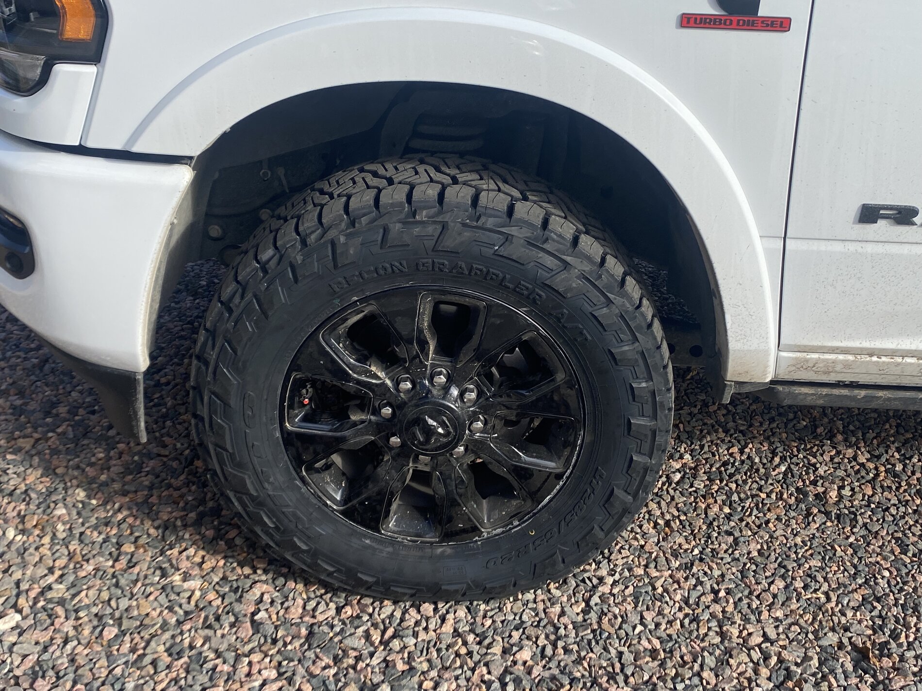

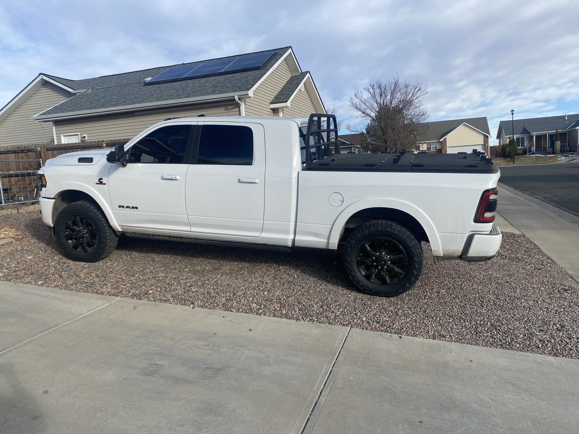

Just had the 285/65/20 Nitto Recon Grapplers installed. Factory suspension with rear air. No fitment issues. No rub at full lock and look way better then the stockers. They fill up the whell well nicely. I’ll get a feel for the noise and ride at highway speeds tomorrow when I head to work.

View attachment 139305 View attachment 139306 View attachment 139305 Just had the 285/65/20 Nitto Recon Grapplers installed. Factory suspension with rear air. No fitment issues. No rub at full lock and look way better then the stockers. They fill up the whell well nicely. I’ll get a feel for the noise and ride at highway speeds tomorrow when I head to work.
Update: Drive about 40 miles to work. Took some county roads and the highway. Rode nicely. No more noisy then the factory Firestones. Balance beads seemed to work well, no vibrations. Overall happy with the tires. Time will tell on treadwear.

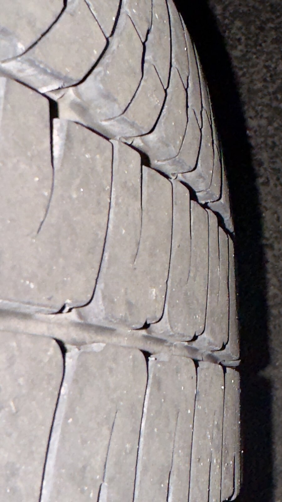

Just turned 90k. Put on a set of Michelin LTX’s at 28,000 mile. i still have at least another 10k left on them. Best tires I’ve ever owned. That’ll be 72,000 miles with a ton of towing and off road mileage. Pretty impressed myself.
Rotated every 10k and run 65lbs air.
Regen, that's really impressive.
65 lbs of air front and rear?
