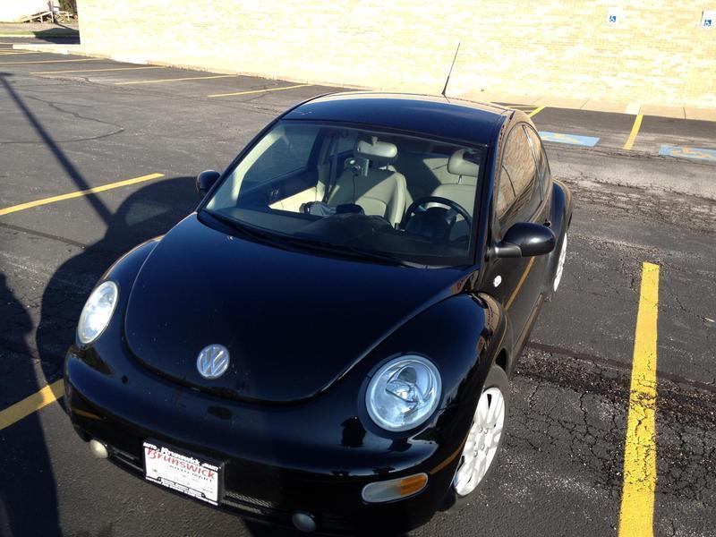

Well its a lot older of a vehicle than what I was looking for but couldn't pass it up given the history. Found an 01 Beetle TDI with a 5 speed with 118k well maintained highway miles. Black with tan leather interior and owned by an elderly lady. Acquired all the service records (dealer serviced as well). The only thing I can see this car needing in the for seeable future is a set of tires and an oil change in the next thousand miles. I bought it for the wife for a commuter car as her new job is almost 40 miles each way (depending on which office she has to go to that day) and we've been pounding the miles on our new family vehicle. Like I said its a little older than what I was looking for but this car is a sweet heart and after speaking with the lady we bought it from and given the service records I have no concerns about putting her in it. I figure for what we gave for it were certainly not going to get hurt on it. If I can get the keys from her I plan on driving it as much as I can, this car is actually a blast to drive and just sips the fuel! I put on 105 highway miles yesterday filling up before iI left and topping off again when iI got home and used just under 2. 4 Gallons..... not too shabby.
