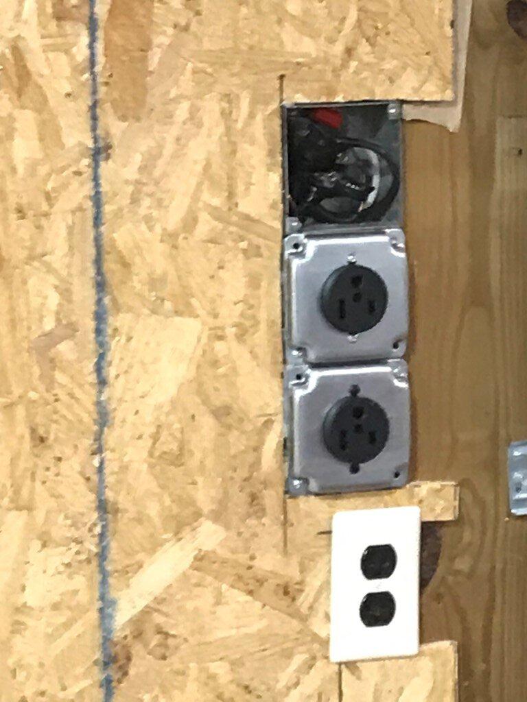

I wanted to add 2 receptacles for the welder/plasma cutter so both could be plugged in at the same time. Not used at the same time, but if you leave it plugged in, the fan can run to cool it while you use the other. Not thinking, I did this - see the problem?
Yes, you can't plug in both due to cord placement - the cord comes out the BOTTOM of the plug, so you can only use one plug at a time....sigh.....so, moved the junction box to the middle and now it works ok.

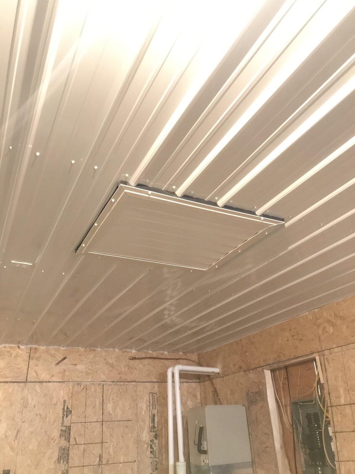

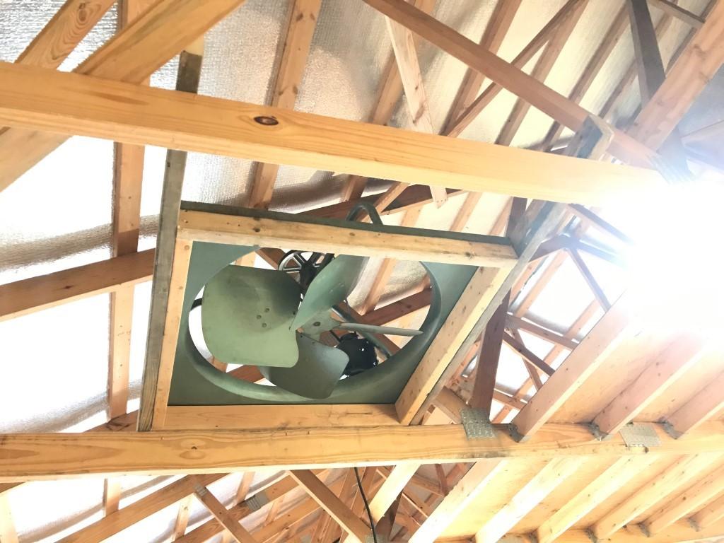

Got a "whole house fan" mounted - it will have louvers under it to help prevent heat escaping in the winter. I'm going to add another to have 2 - I want ventilation when doing something that creates fumes!

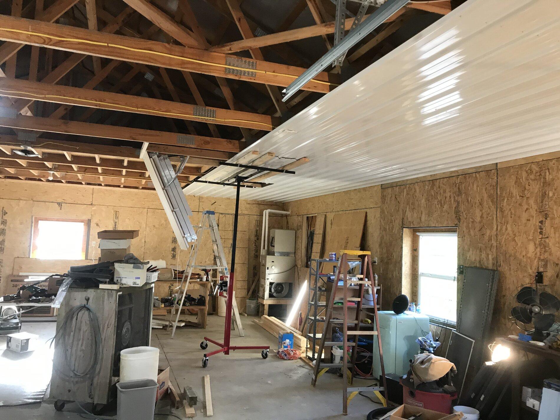

I bought a drywall lift to help do the ceiling - works great for lifting fans and attic stairs too!

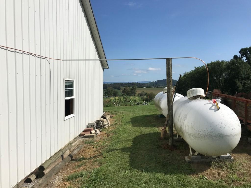

I got the propane run to the heater. Decided to go above ground for now - can easily change it later if necessary. Plus, my elbow has been bothering me, so using a digging iron isn't recommended right now.
After I got it all run, did a pressure test - wouldn't hold the 6psi. Found that I never tightened the fittings at the heater. That is the problem with doing something over a week ago. I use 6psi for testing. The 1st stage regulator is set to 10PSI.

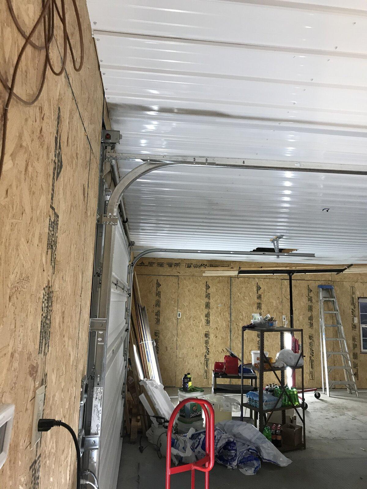

I've settled on using metal for the ceiling. It will 40% more than drywall, but will be much easier and faster for me to install.
Regarding another garage door - that will have to wait till later - so I'll have to shuffle things around with only having 1 door - oh well.

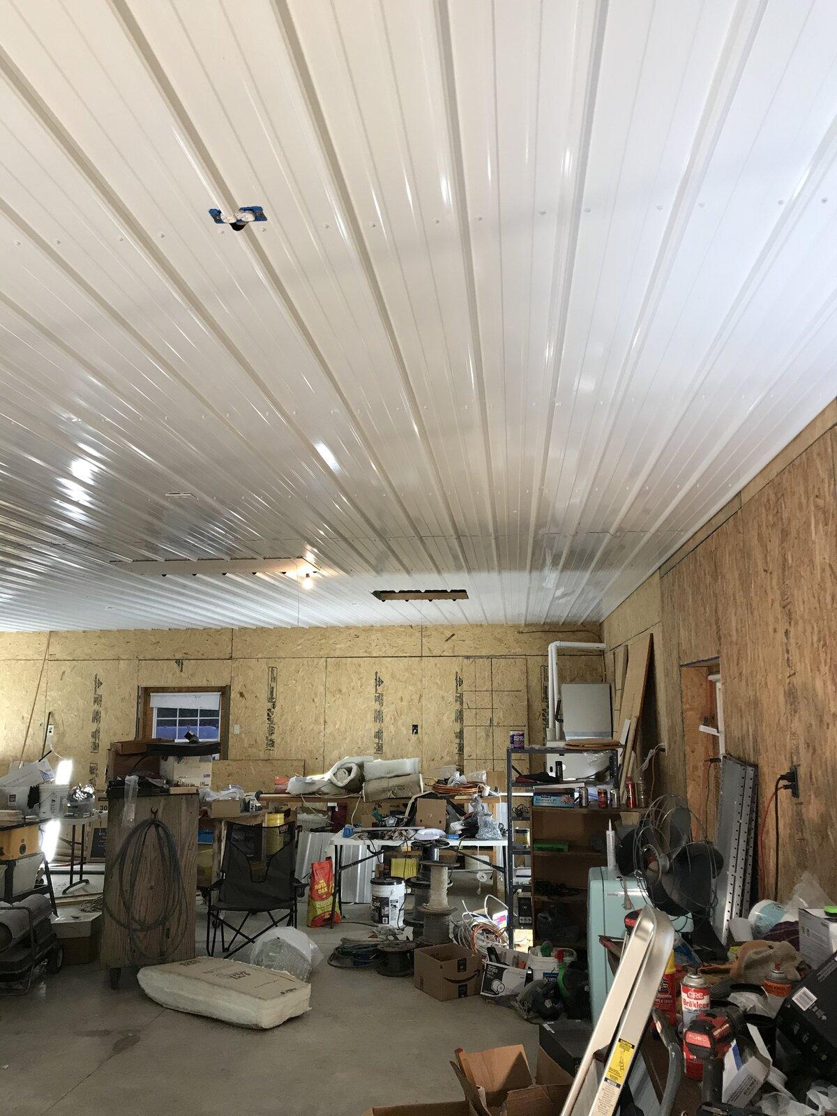

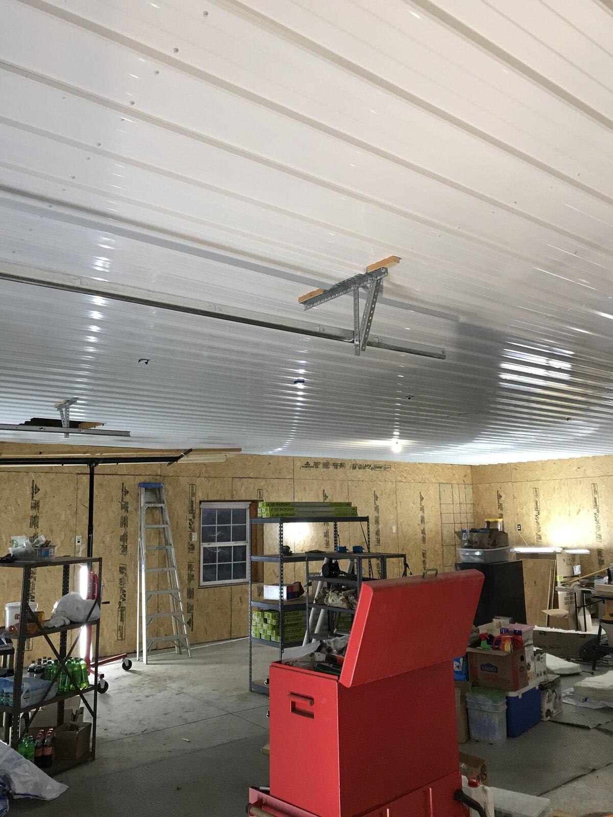

Finally got the ceiling up. Wow - I'm getting old! My Body really doesn't like going up and down an 8' ladder a bazillion times and working over my head while on the ladder.
The rectangular holes in the ceiling are where ceiling fans are installed.
Last night I got the louvers on the fans. When I turned one fan on, then the other, the second fan wouldn't open the louvers....Crap - why....Then I realized I have the whole building really sealed up now, I bet if I open a door or window they would work just fine. Guess what - they did and they move a LOT of air. Should be easy to ventilate the building now while welding or doing things that create fumes I don't want to breath. Each fan has it's own switch and each have a high/low speed. Initially I had a new fan and a used fan. Now I have 2 new ones. The used one died while letting it run one day. At least that happened BEFORE I got the stinking ceiling up!!

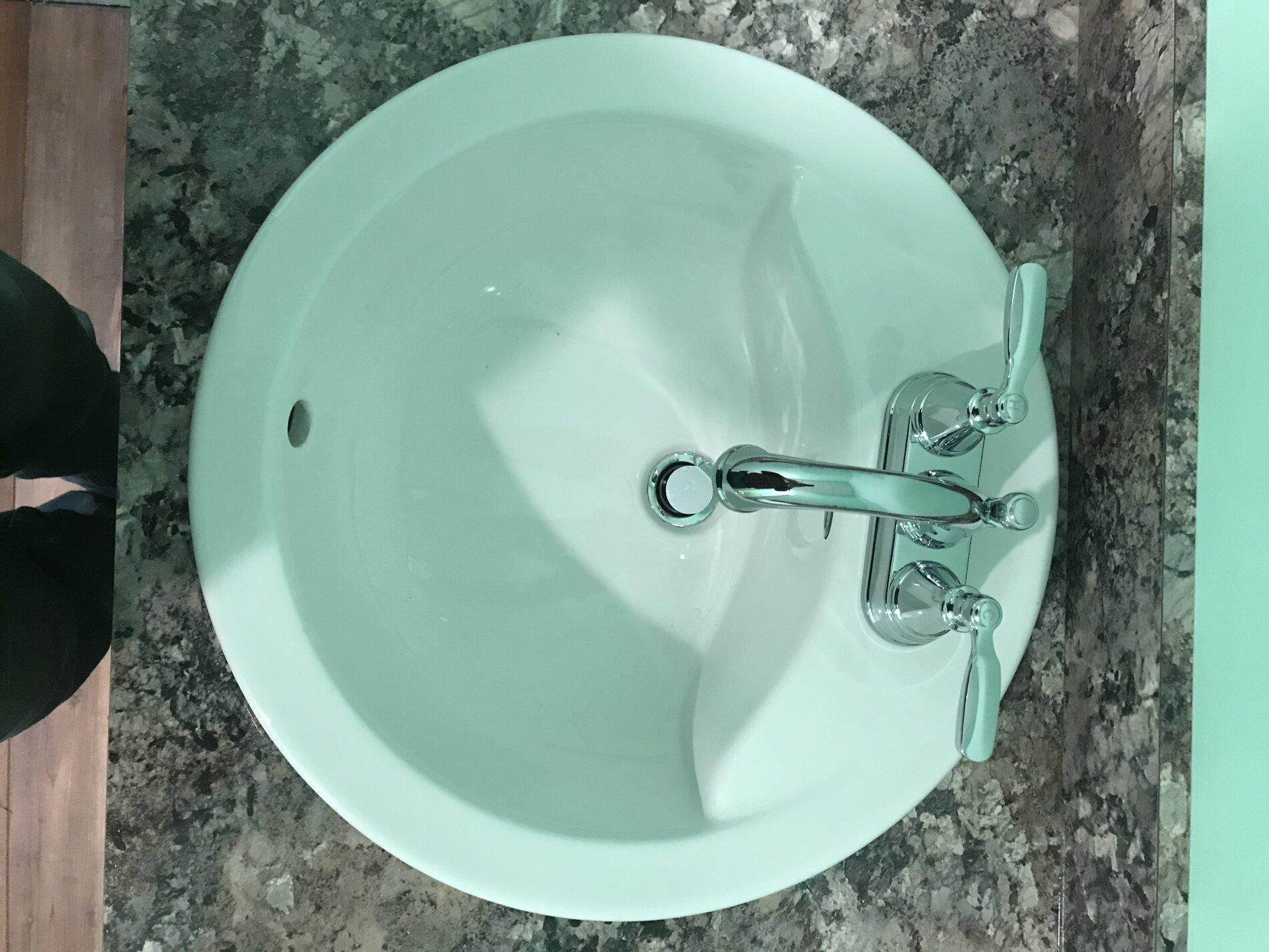

Bathroom sink - installed crooked. (and sealed down - hopefully they can remove it w/o hurting the laminate top of the vanity.

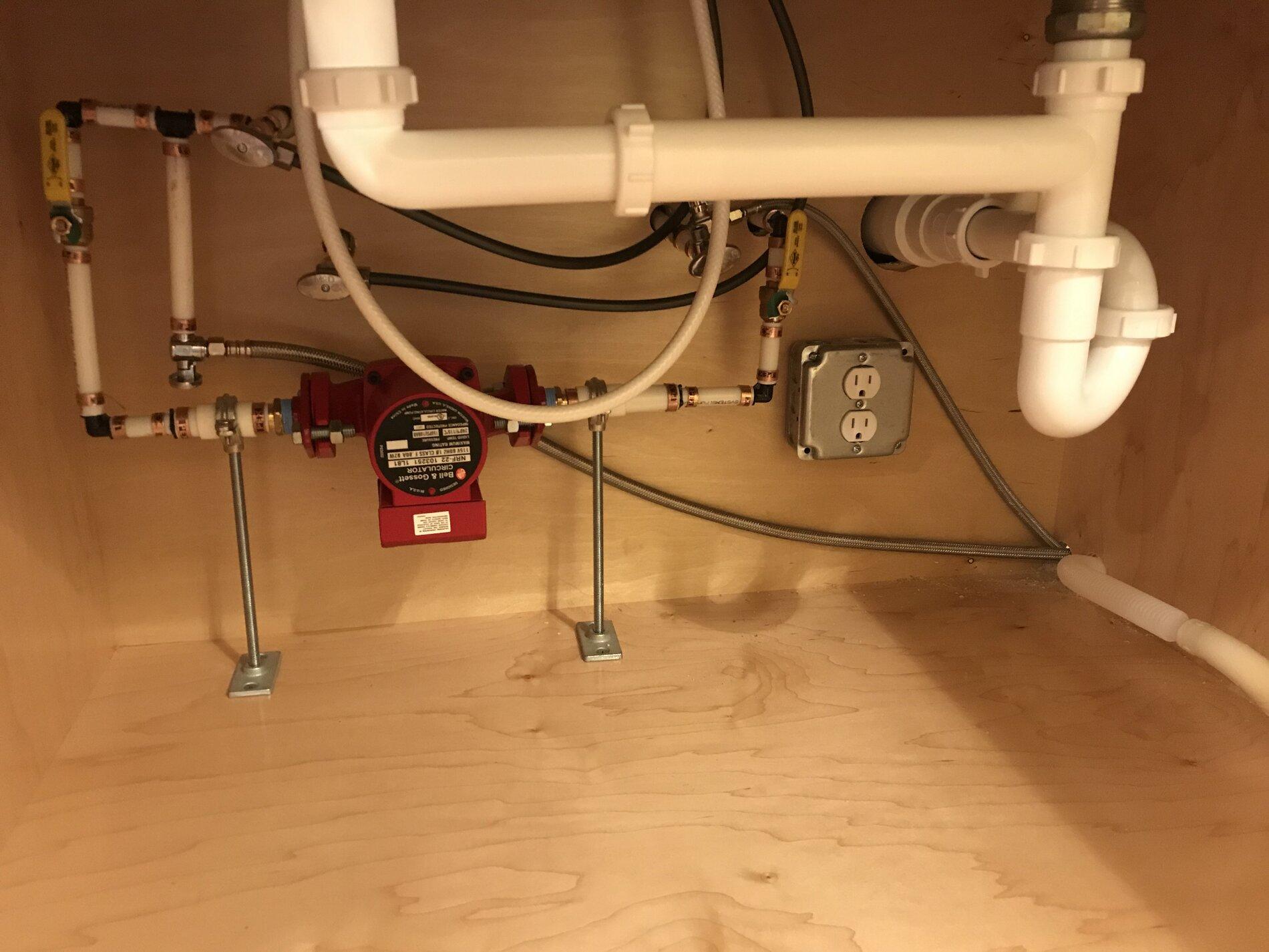

They installed the circulator pump I asked for - said they have done it before. I looked at it and....it is upside down. Will it work - SURE. If it leaks, the water drains into the electrical box.
OH yea - and the outlet for the circulator isn't on a GFCI.....sigh.....guess I have to do it myself.
