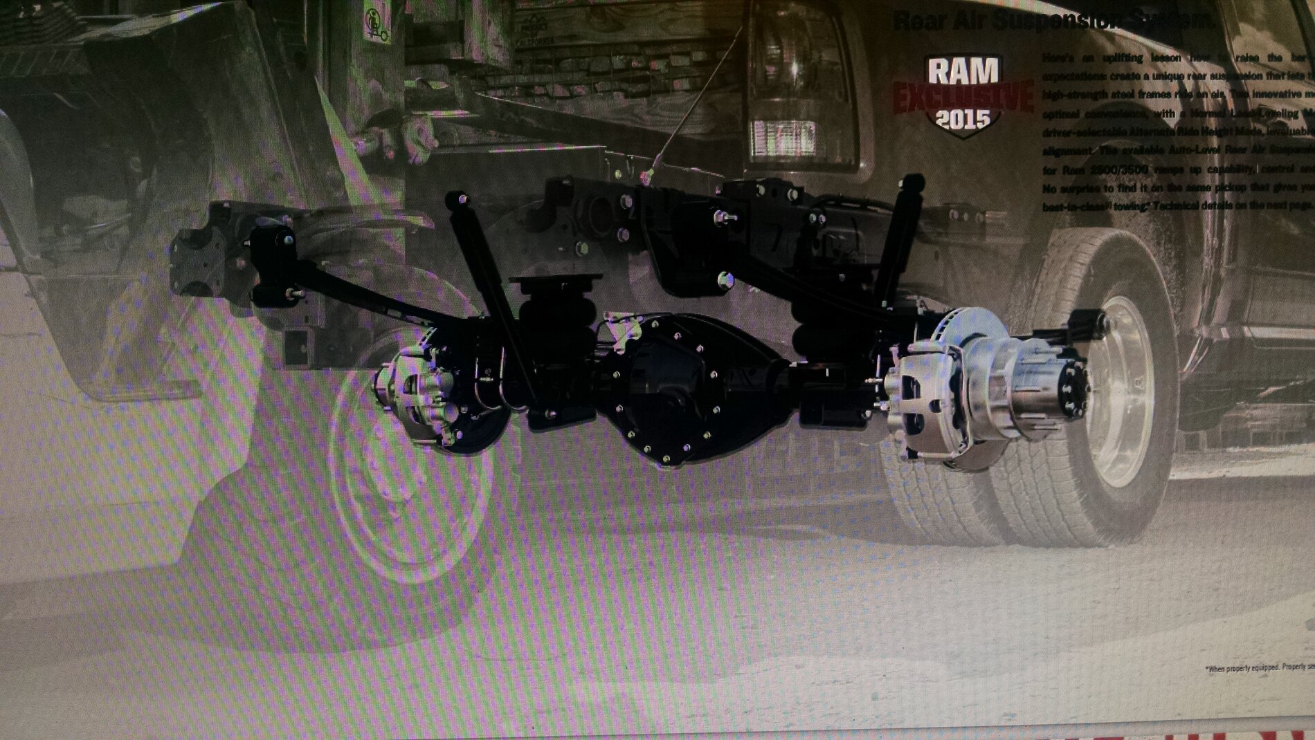

I think that Ron's 2015((first year) has slightly different leaf springs than the later ones. As I recall, they changed something after the first year.
