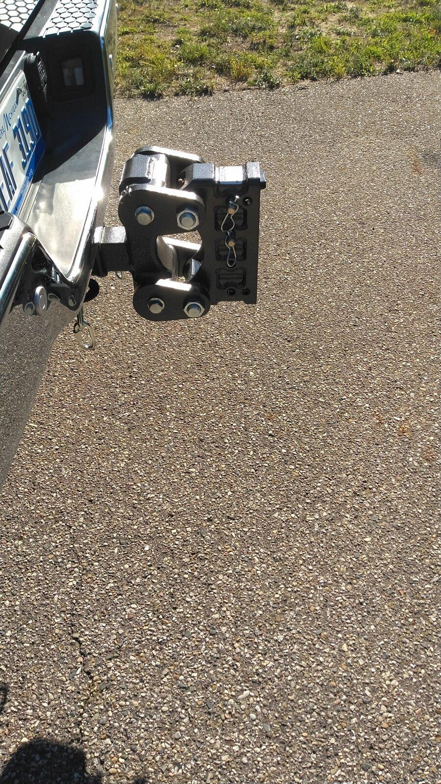

Also. I wore out and he Andersen. Cone material gone. So I now just drop 1200 lbs on the ball and the ride is incredible. It's a game changer big time.My only suggestion, and I have a 2wd is get the Laramie upgrade. The seats are very comfortable and this one had very few options added. Sticker was 62k. Got it for 48k. But it sat on a Michigan lot for 2 years.
So far very happy with 2wd. It is lower and very smooth ride for a HD. But, I have 30k tow strap in the rear floor compartment just in case!
It does stick out in the back. Too heavy to take out.Also. I wore out and he Andersen. Cone material gone. So I now just drop 1200 lbs on the ball and the ride is incredible. It's a game changer big time.
