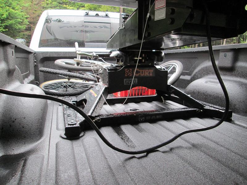

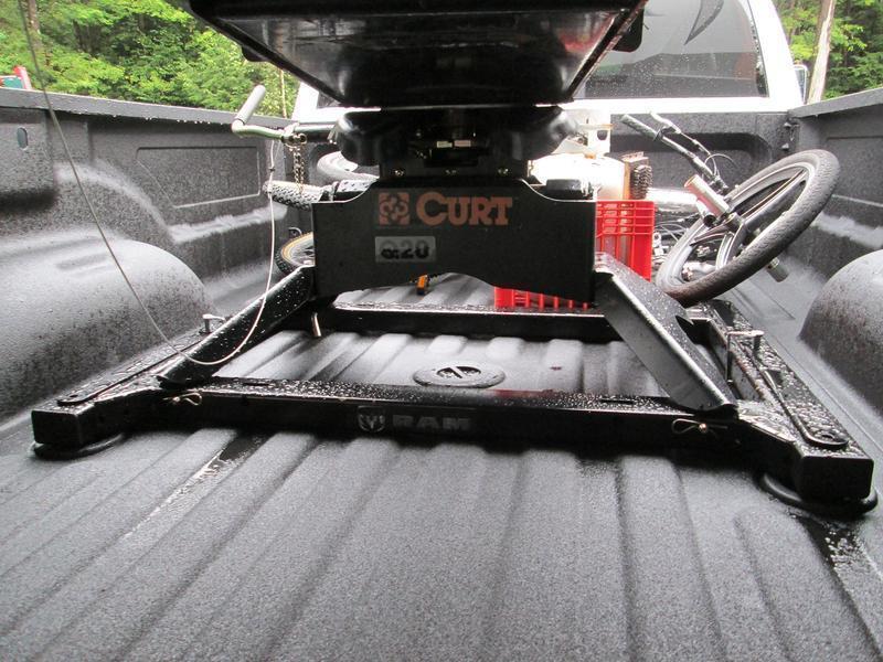

Can you snap a pic of your factory hitch? I'm curious to see one.
Here you go Powder, the hitch I had already, it is a Curt 20k. It just so happens to be the same hitch Dodge sells with their sticker on it. I really like the trailer plug in the bed too-
