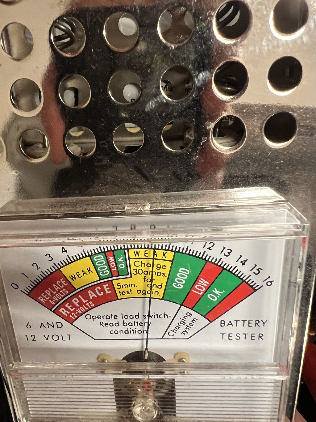

Something of a head scratcher - Yesterday I unhooked both batteries and let the truck sit overnight so I could measure the resting charge voltage separately. When I went to hook up the batts, I was connecting the passenger side neg cable, (the driver side batt still disconnected) and the horn started to honk like you pushed the panic button on the fob, wouldn't shut off even when pushing the button on the fob. What did I do wrong?
Both batts measured 12.6v. They were just installed recently by the dealer.

The question is "when" does the battery hold 12.6 volts. IMO this is part of the reason the tests at the dealer take so long. A battery holds a surface charge: after you shut the engine off you are reading 13+ volts on a battery for awhile. 24 hours later with nothing connected is when you can take a true voltage reading. A cell that's loosing voltage in a bad battery will start to discharge the good battery. We see many that swell up the battery cases cracking and buckling the internal plates here.
you can remove the surface charge simply by turning on the headlites or another electrical load for a few minutes. you dont have to wait a day for the surface charge to dissipate.. also worth saying a battery will hold 12.6vdc for awhile, but all batteries self discharge over time, faster in hi temps.. I believe the battery gurus say a battery will self discharge about 20% in one month in a warm to hot environment... self discharge rate is lower in cool or cold conditions.. so while a battery loses power the colder the battery is, it also holds a charge longer. so for storage its better to keep it in a cool place, but for electrical effictiveness it works better at higher temps. Getting old enough now to forget some of this stuff, but I seem to remember in the old days batteries used in a really hot climate, they used a slightly stouter electrolyte, which had a specific gravity a bit higher than what is standard nowadays.
