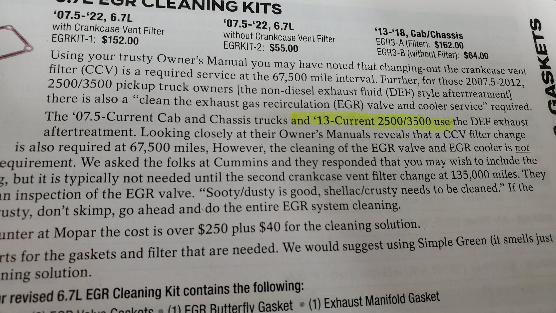

This is what is on Geno's site. They are talking Cab and Chassis trucks. I don't see any mention of 13-18 pickups.
"The '07.5-Current Cab and Chassis trucks use the DEF exhaust aftertreatment. Looking closely at their Owner's Manuals reveals that a CCV filter change is also required at 67,500 miles, However, the cleaning of the EGR valve and EGR cooler is not a requirement. We asked the folks at Cummins and they responded that you may wish to include the cleaning, but it is typically not needed until the second crankcase vent filter change. They did suggest an inspection of the EGR valve. "Sooty/dusty is good, shellac/crusty needs to be cleaned." If the valve is shellac/crusty, don't skimp, go ahead and do the entire EGR system cleaning."
https://www.genosgarage.com/product...rankcase-filter-egrkit1/crankcase-vent-filter
The quote you posted from Geno's is on their C&C EGR cleaning kit page, so it makes sense that it's only talking about C&C motors.
.....and from the print catalog.....
One problem with the "07.5-Current Cab and Chassis trucks use the DEF exhaust aftertreatment" statement. C&C didn't get DEF until 2010 or 2011 not that it matters much to the argument.
