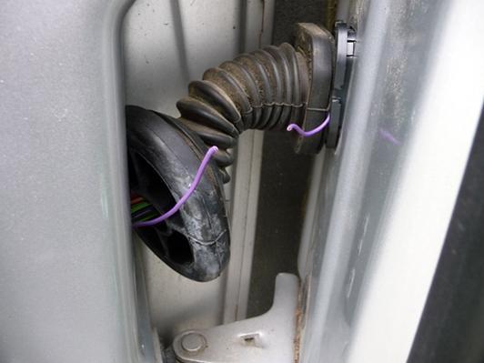

Door open (lights/buzzer etc. ) was not working, did some reading and found this thread, thought I'd add a picture of the broken wire. Splicing wasn't too bad, dealing with that boot was the challenge. BTW, the wire sure looked like copper to me and my solder.

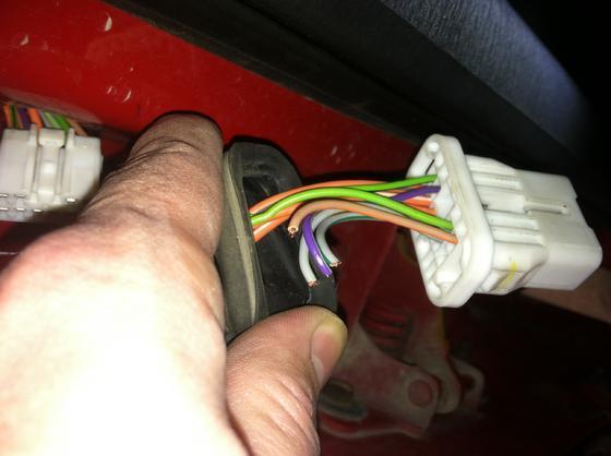

V1SC, I spliced mine two weeks ago, looks like I have about 50 more weeks before it happens again. Four of the nine wires in my harness were broken, and 3 more were showing copper through the insulation. I had no speaker, door locks, or interior lights.
Attached a shot of the carnage. Definitely book marking this site. This is what I try to explain to my wife, how my TDR membership pays for itself. $117 dollar savings every time I have to order this harness!!!
