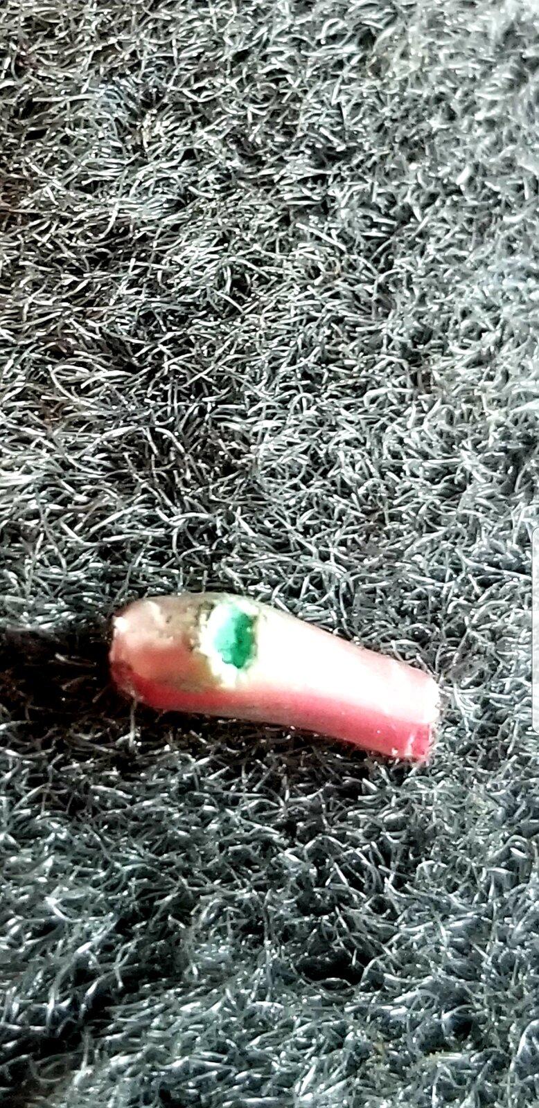

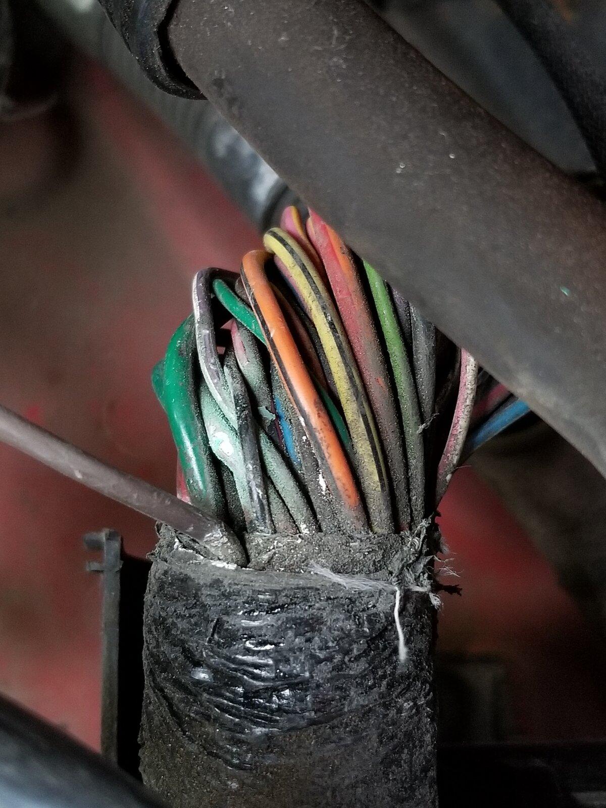

Glad it's fixed. Probing is fine but the puncture needs to be sealed, when I was still working I would use 3m scotchkote but it seem's a little pricey for the individual especially when your not using it most of the time. Maybe liquid tape ?. Just a FYI for any future endeavors. It took 50ish years for that B-52 wire to burn in half and it was in the middle of about a 100 conductor bundle.
We avionics types "discovered" the TDR (Time-Domain Reflectometer, not this fine group or magazine:D) amongst the dusty equipment on the top back shelves of the dark equipment room. Sure saved the extensive job of lots of panel removals and shaking the wire bundles along the wings and through the fuselage. The TDR pinpointed the problem in the harnesses within an inch or two.
