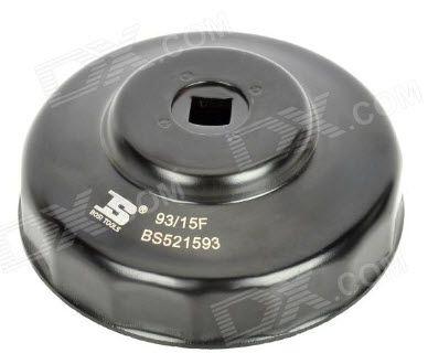

If you're hoping to use that from below, I'm sorry but you will not have any clearance as the below access is blocked by a cross member now. I recently tried to change my oil by going through the wheel well, but I seem to have extra pipes and stuff in the way, so I can't physically fit my oil filter through the wheel well. I've had to take the intake off to get this latest oil change done once again. Also, when I did my first oil change, I used oil filter pliers to bust it off. It is no exaggeration when people mention the Cummins Gorilla installing these things.
nice... guess I can retire it to the useless tools drawer in my tool box.
I remember pulling the first oil filter off the 06 model.. Thought someone from Caterpillar put that thing on!
jus2shy, are you saying one can't get the filter out from below at all? And here I was hoping to use a bowl-type filter wrench (similar to that shown) and get it loosened from below.
What are the chances of getting this onto the filter? Several lengths of extensions might be needed. If it can't be accessed in a straight line, a u-joint included with the extension could help.
jus2shy, are you saying one can't get the filter out from below at all? And here I was hoping to use a bowl-type filter wrench (similar to that shown) and get it loosened from below. View attachment 88155 What are the chances of getting this onto the filter? Several lengths of extensions might be needed. If it can't be accessed in a straight line, a u-joint included with the extension could help.
This is only a problem for those that have the newer frame. So really only 2014 and up, or 2013 3500's. 2013 2500's and pre 2013 rams can still get at the filter from below.
That's good to hear, I was very much hoping that could actually extract the filter from below on my recently acquired 2012 2500. Thanks for your clarification.

Will the bowl/cap filter wrench work with a ratchet wrench through the wheel liner notch?
Chris
I actually tried to follow that video. I'm wondering if there's something up with my truck though. I can't physically fit a mopar MO-285 or Fleetguard LF16035 through that gap. The hoses and such are too tight together and I can't move either hose around because they're hard mounted.
