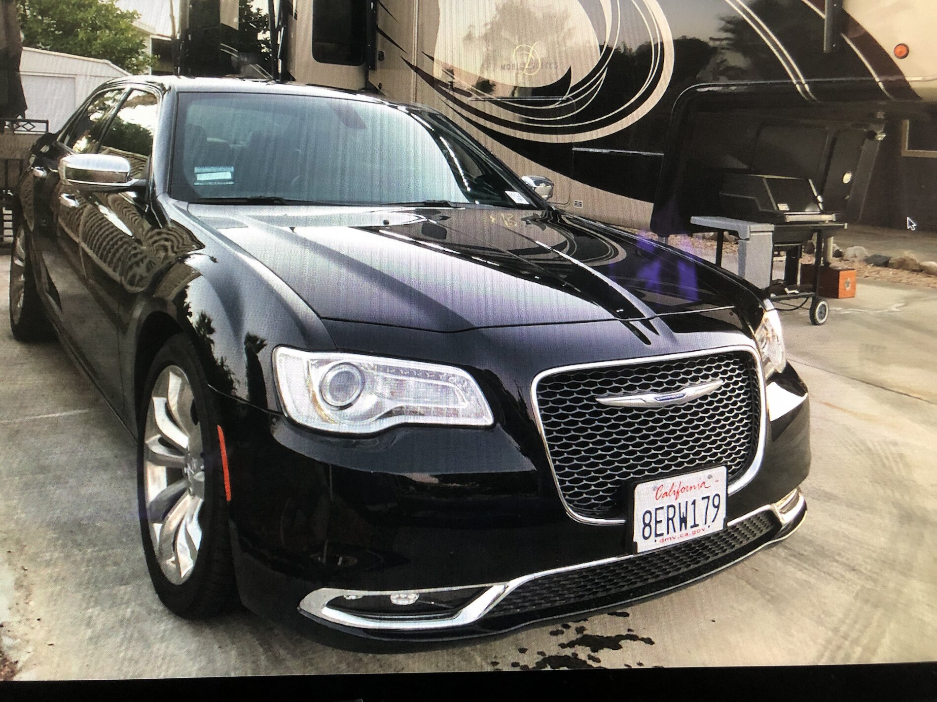

My 15 front seal leaked and it was fixed including a nice rental car. Note spots on concrete.
Thanks guys, I was thinking it might be front main. Thankfully the leak isn't as bad as in the picture-yet, at least! I've only got 35k miles on it and first time I bought the Maxcare. Used it once to replace the radio and now this so might have been money well spent!
