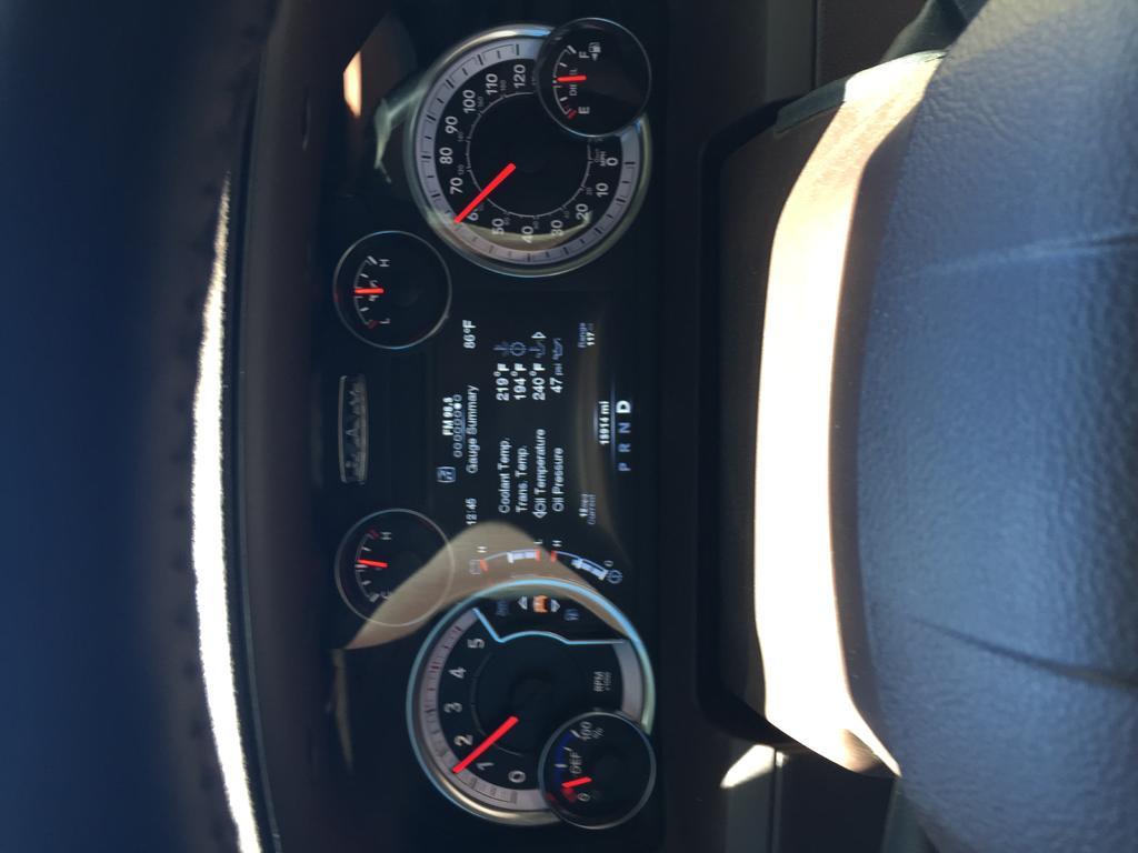

I've seen threads about this but I have never heard or ever saw my temps get hot until this past weekend. We usually always have a boat or horse trailer behind us along with our camper. This time it was just us and the camper. We were on our way to Cultus lake out of Bend Oregon. Its a gradual climb but nothing extraordinary, temps outside were not bad. Yet we hit 240'F for our oil temp.
Based on your coolant temperature of 219*F, the oil temperature is about right. I've seen oil temps around 10*F to 15*F above my coolant temps. Generally, after the coolant temps hit 215*F to 217*F, the fan clutch starts earning it's keep.

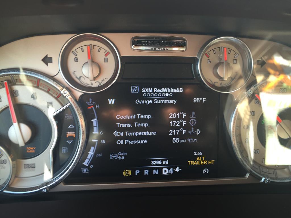

Comparing the two photos, I find it interesting looking a the engine rpm vs. the engine temperatures since both trucks are traveling at approximately 60-mph. Yet, the cooler engine is more heavily loaded and running in a higher ambient temperature. Notice also that the cooler engine appears to be running with the transmission in 4th gear, and according to the post, is 5 miles into a 5% grade.
Bill

And further comparing the trucks, doesn't the hot truck have dual radiators?

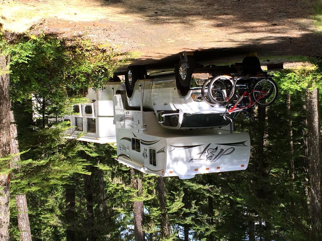

There is always more to the story.....we were hauling 4 bikes on the front of my truck. This would confirm that the 4 bikes do in fact affect the air flow considerably to the radiators.
Thanks for the "more to the story". I suspect your bikes on the front do inhibit air flow. I've seen spare tires on the front that restrict air flow even more.
