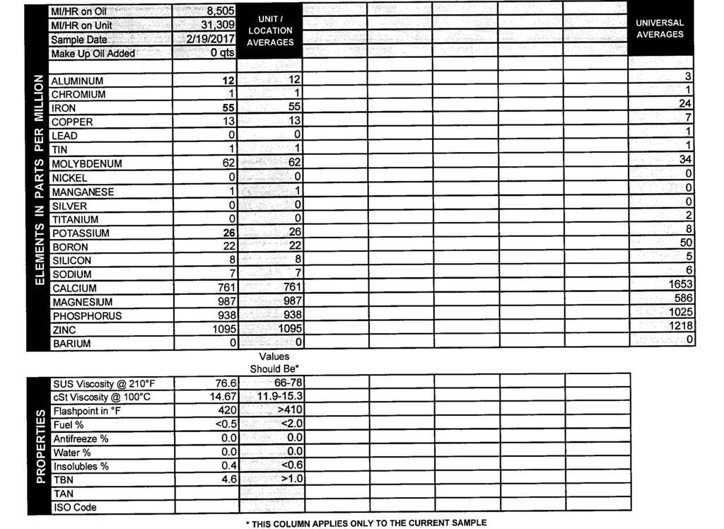

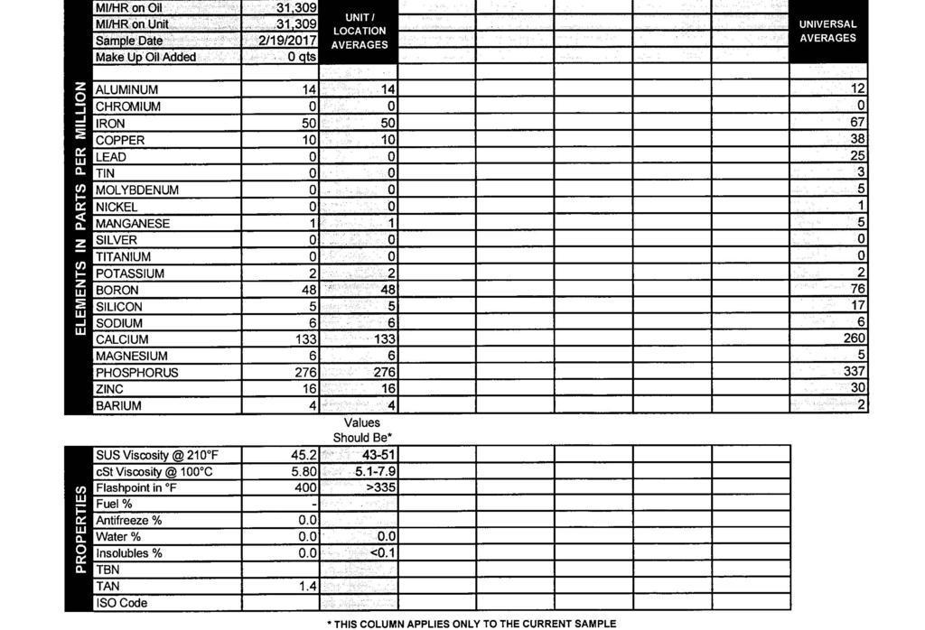

Just wondered thoughts on the lab results. Blackstone seems to feel all is good, just wondering what you guys think. Seemed crazy to me that the transmission fluid needed changed at 30K, but I followed the manual. Although I changed the filter as well and while I had it apart I added the PML pan.
