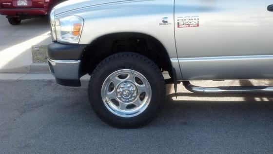

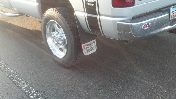

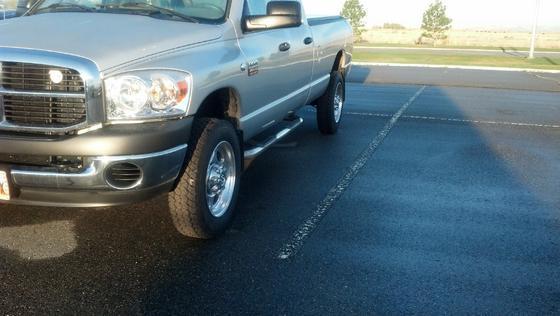

Heres a pic of my Ricksons rims and tires. . the offset is not bad at all. .
The tires on this set are new and I had a Michelin set before that towing my 36' 5th had never had a problem. . I had this on my old 2001 Dodge 2500 and now it adorns my 2009. . I run 225/70R-19. 5 "G" 14 ply Toyo Tires. Don't like these tires as much as my old Michelin 245/70R-19. 5" 12 ply "F" Still have one as the spare and it fits in the spare location.

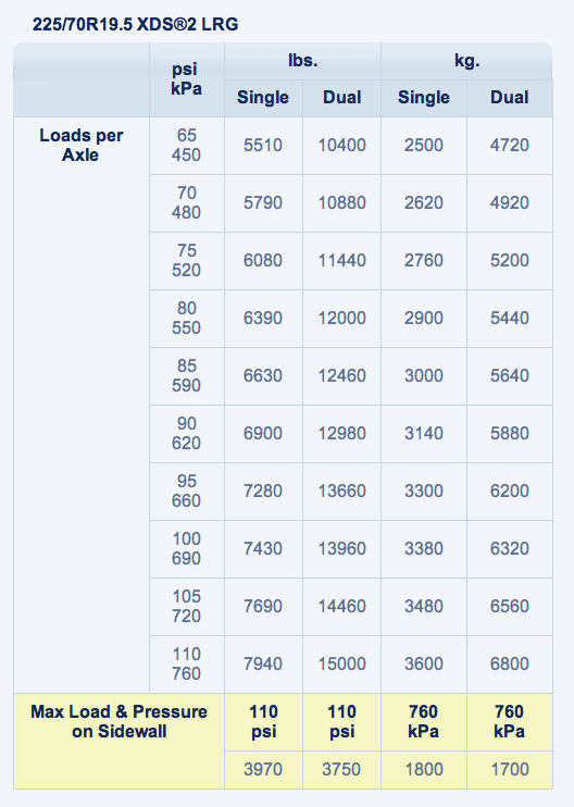

In terms of weight, a little more research shows the wheel/tire combo not weighing much more then 90#, so hopefully there will be less, if any, wear effect on the suspension components, compared to oem. The spare, on Rickson steel 19. 5, weighs closer to 120# but will only be used in an emergency. All that being said, I am hoping that LRG tire is not TOO stiff for my liking, but eventually I can get other tires... it's the rims that are near impossible to find now.
I don't air down too much. . I drive truck for a living so the rough ride don't bother me. I run around 90 psi. The ride is a little stiff but you would have to run like 65-70 to get a softer ride but don't know if that might be too low to have uneven wear.

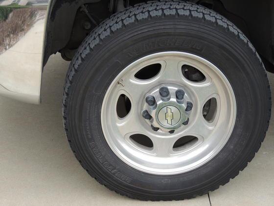

And just for the hell of it, here is a pic of the actual wheel/tire combo I am going to buy--
Of course you can ignore the chevy hub... lol

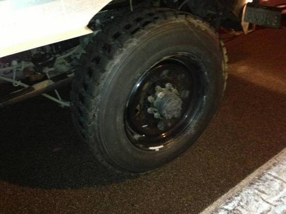

Run them, you know what your getting into. It's a fair trade off. I'm running 19. 5 on one of my trucks. It's the truck I use as my daily driver and the truck that gets used to tow my heavy camper and race trailer rig. I'm close to max GVWR in my Chassis Cab 3500 and the 19. 5 were a no brainer.
I did have to change the rear suspension to a full air bag set up for it to be a daily driver, but mind you, the Cab and Chassis 3500 Dodge has a completely different rear suspension and frame than the 2500/3500 non Cab and Chassis truck.
The trade offs to run the 19. 5's were a no brainer on this truck.

My ride was rough because my truck is a Cab and Chasis 3500. The leafs packs on these trucks are 2x what a standard 2500 or 3500 are.
The 19. 5 made a difference in ride quality, but it was nothing unbearable for a daily driver. I didn't mean to mis lead you, so I'll clarify.

So you went from a 3500 Cab Chassis dually to 19. 5 SRW? Or am I missing something?
