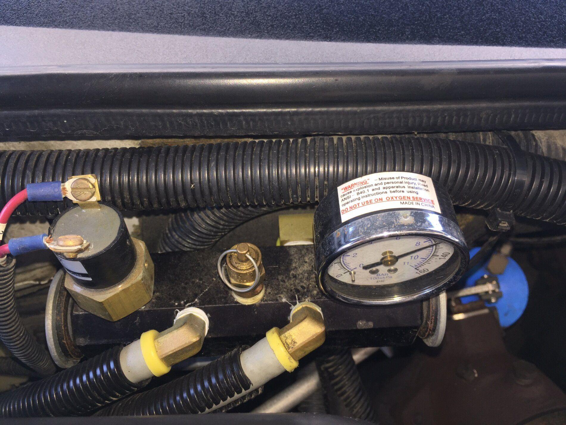

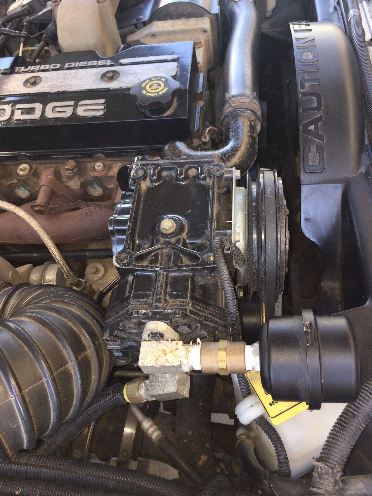

I’ve been using a York engine driven system on my 01 for years now. It moves a lot of air quickly. My only complaints are it also pumps a lot of oil out through my air lines and it threw the belt once. I upgraded to one of these and it helped with the oil problem.
https://offroadonly.com/finally-a-york-compressor-designed-for-air-operation/

I had the York in y 03 but the 18 seems to no room or it
I was thinking that it may fit in the location where the optional 2nd alternator mounts.
Anyone have a closeup photo showing a 4th gen 6.7 engine with that optional alternator?
