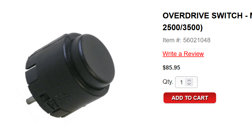

Are saying that you don't have this button (in the photo below) on the end of your transmission shifter? This overdrive lockout switch is stock on a 2001 truck.
- John
I had a 12 valve before this one and the button was on the dash. I never knew they relocated the button on the end of the shifter. 4 years I never knew it was there but then with the price of fuel I did not use the truck that much and hardly ever in the winter so as to not get salt on the truck. Learn something new every day
My 1998.5 had an O/D lockout button at the end of the shifter. It stopped shifting into 4th and allowed T/C lockup in 3rd.
That’s the way it’s supposed to work. With OD off, it will lock up in 3rd. It’s simple to take that switch apart and clean the contacts. I posted a thread about it with pics years ago.
