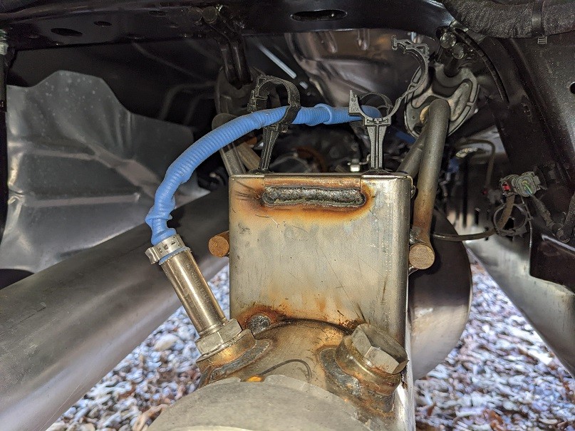

Ok called my friendly? Local dealer today to see if I could get my 2022 3500 ho aisin in to get the sensor and module installed. I was informed that I would have to bring truck in for inspection on one day to see if it already had one . Then make another day appointment if it didn’t to have one to install . Two trips to the dealer and you can’t just do a drive in and wait inspection . They are only getting two a week so demand is high supply is low. Anyway can I /we my35 year old step son look to see if I already have one . I’m creeper impaired . Dealer said some trucks about 25 per cent came from the factory with them . Maybe I already have one
And what bad things really happen if I don’t have one ever installed. Will I be sorry latter
It’s in layman’s terms a early warning device for if your DPF fails internally and passes soot. Could be helpful if still under warranty it will alert them there’s a problem and it may be covered. Other than that, I don’t see any reason you would be sorry.
It’s very easy to see if you have one installed, and I haven’t heard of any 2022’s having them from the factory.
Look at your SCR outlet, do you have a sensor at the 2 o’clock position or a plug like this?
Good picture. Will have him look when he comes over next time I assume this is of your truck and it’s not been installed yet either
Good news. Got a call yesterday could they install my sensor today. 8 am drop off and I would wait. Said about a hour and maybe half . It’s done My cudos to Anchorage Chrysler. Now all my recalls are done
