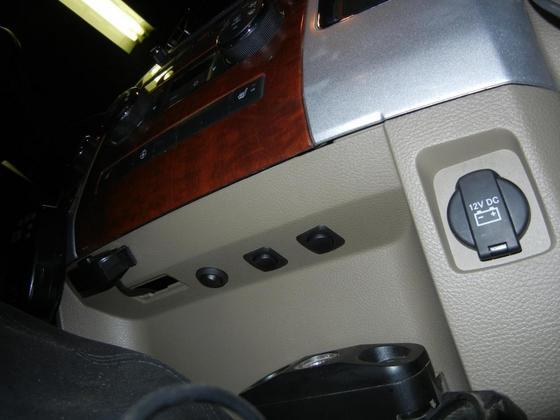

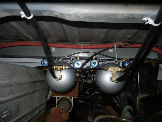

Just thought I'd share some pictures of the air bag ping tank setup I just put on. Starting with the 2010 trucks the only ones that get overload springs are the 3500 DRW so I decided to put on a set of Pac Brake air bags after reading the article in the TDR (issue 78 page 124). I went so far as to wire in my own in cab controls to inflate/deflate the bags and pressure sensors on each bag and the main air tank.

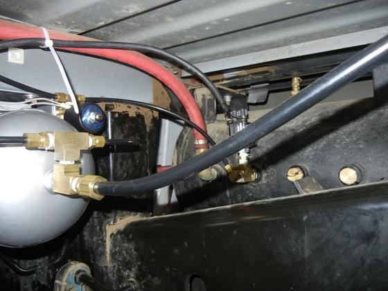

Nice job, clean install, you did some planning and it shows. Let us know how they work and what you feel with them in the system. Are you able to close them off for a before and after test? Also, did you have any leaks at the compression fittings? They always seem to need a few more turns.

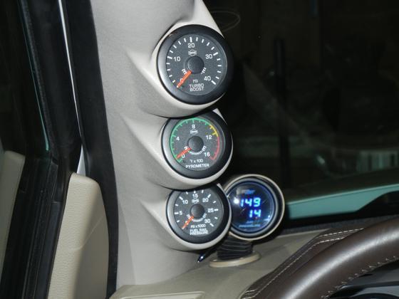

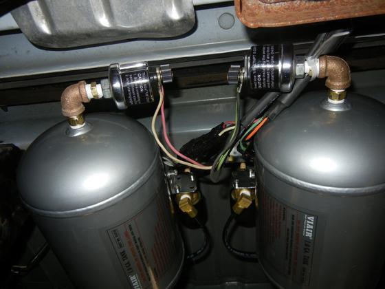

Are the pressure sensors electrical so you can switch the inputs at the gauge to read the various locations?

I had only one of the compression fittings leak, I use tube insert sleeves.
Yes the pressure sensors are electrical (www.glowshift.com). The left switch is DPDT that switches between the left and right bag/ping tank. The top readout on the display is the main tank and the bottom is the ping tank either left or right. The other two switches are to inflate/deflate the bags.
I used 3/8" Marson threadserts into the front bed cross member to mount the tanks.

I see four air solenoids, one each for air in and out I assume? If that is the case, how difficult is it to add or release a small amount of air into the system?
You are correct, one pair of valves on each side. One is inflate and the other deflate. I've been able to adjust 1 or 2 PSI at a time. I used 1/4" tubing for that side of things so that I could have better control. The deflate valves have 1/8" air tool mufflers so that provides some more restriction and control delating.

Kevin, it looks like you used 1/2" air line between the bags and the tanks, right? Since one wants as much volume flow as possible for the tank to serve the purpose that would make sense. The fitting into the bags are only 1/4" typically as well as most small tanks. What size of tanks are those? 1 gallon tanks? I see that they are Viair, and the Viair ones that I can find only have 1/4" fittings, at least on airbagit.com's site.
Yes the tanks are 1 gallon with 1/4" NPT threads with 1/2" lines between the tanks and bags. I don't feel like the slight reduction in the internal size of the fittings has caused any problems. Remember that the 1/2" tubing is 1/2" OD. I got the tanks and valves from www.hornblasters.com.
