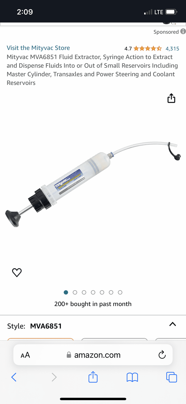

Years ago I long time (forever) borrowed my wife’s turkey baster to suck some power steering fluid out of my old 99 24 v I put a hose clap on it to keep it together etc., But it was a bit messy sometimes. Now I have a big suction gun like a grease gun size . I have not tried it on the power steering yet but I’m always interested in something that works better to do this. What seems to work the best
I have used this for several years. Good quality and chemical resistant. Brake fluid, ATF etc. $29 on SCAMAZON.
