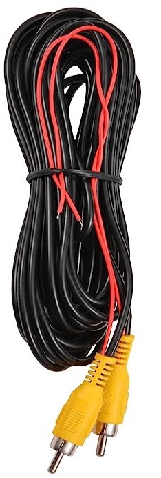

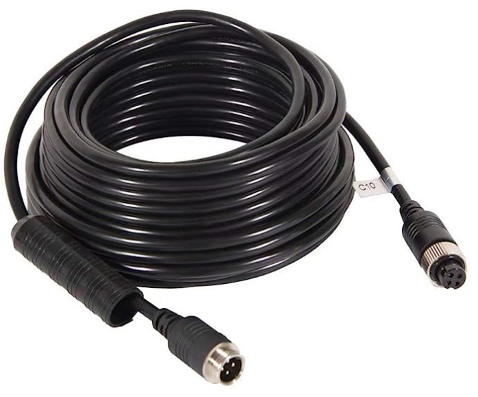

I have the headliner out right now. This seems to be the time to pre-wire the cab down to the chassis for a backup camera. I don't yet know what I will use. But I expect I'll install an oversize dual-purpose rear view mirror. But which mirror? And what kind of wire?
What have people been using? The pictures show two kinds that I have found.

The first one uses RCA type connections. The second uses four wire connections with screw-tightening ends. What kind do y'all recommend? Though at the price, I could install both I s'pose. Then Murphy's Law says that both would be wrong.

RCA - it's the most common from my research. Almost every aftermarket camera comes with it.
And there are still pigtails if you need to switch from one to another.

@Matt42, I'd run the 4 pin and the use adapter at the ends. That way the ends that take most of the abuse can be replaced as needed. JM2C as I've got a camera system that I've been sitting on to install in the truck. It would give me front, side and rear camera on 1 screen. Trying to figure out where to put the screen in truck! It's a 7" with the ability to go full screen with triggers for cameras. Turn signals trigger sides and reverse for rear and thinking just a switch for front. Time and location is the issue! :rolleyes:
