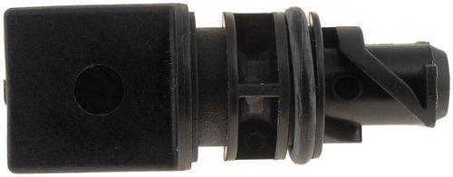

Maybe I'm missing something, but it's no big deal for the drain cock to come out of the radiator. It is designed to turn counter clockwise @ 1/4 turn, then pull out as you continue turning counter clockwise. If you turn it further, it will pull out. That's the way it's made. Get you a new one and you'll see how it's designed. Dorman #61134. Here's a pic:
