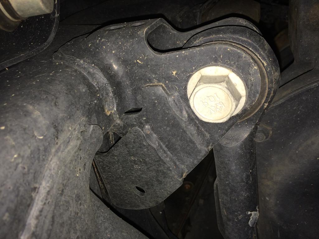

Welding is not my thing, but I did have a look, presumably it's the 'frame bracket' on the driver's side. I'm guessing that it's the very top, flat portion that is difficult to see or access that might be where the welds are possibly thin.
My photo rotated counterclockwise when uploaded, but in the lower-left of the photo, which is up, is what I'm thinking. Am I off base?

Follow the link that Kerwin posted on page 2 of this thread - it shows what to check with pictures of cracked and broken welds.

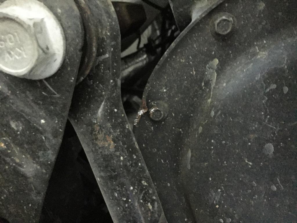

My concern with the bracket is that there is already not enough room under the track bar bracket. See the below picture of where my axle is hitting the track bar bracket when my camper is loaded on the truck.
McCords Ram in Longview Washington has given me a rental car every time my truck was in there for work and its been in there a LOT. This may be from their business link program though.
My concern with the bracket is that there is already not enough room under the track bar bracket. See the below picture of where my axle is hitting the track bar bracket when my camper is loaded on the truck. View attachment 93914
Are you over your FGAWR? Chris
