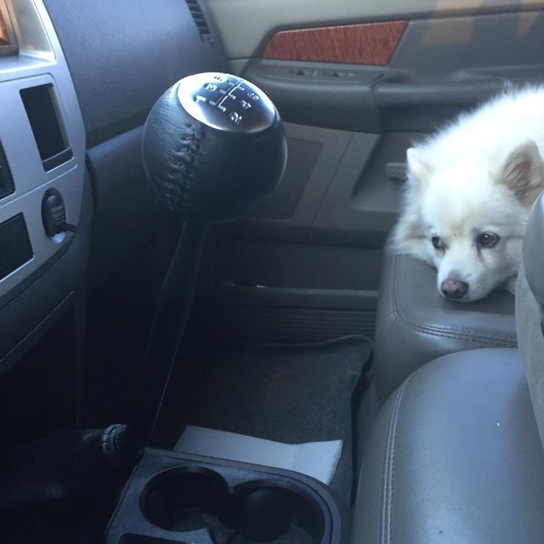

So I want to put a ram SRT 10 shift knob on my G56 shifter. I called the dealer and they tell me they need a Vin number to look it up. Anyone have the part number for the knob or have a Vin I can use too look up this part? I think the guy is just being lazy. I destroyed my knob trying to get it off to fix the shift boot. Really don't want to put the stock one back on if I don't have to!
I'd give you mine but it's a special edition so the stiching is blue. He could take a few minutes and find it. Look for one on eBay.
Just looked it up in my Nexiq program by VIN and I come up with 05037433AA.
So I can't go any further where I am not a dealer. I SUSPECT that 05037433AA is black, 05037433AB is blue where it is a commemorative edition.
Make someone check stock before you order anything.
Thanks guys! Got one coming in from Ohio. Someone ordered it and didn't like the hand stitching. Should work out great. I think I'm going to have to tap the threads to match the G56. Can't wait. Going on a 10 hour round trip snowmobiling Friday so hope to get it on before then!
Got it in Friday!

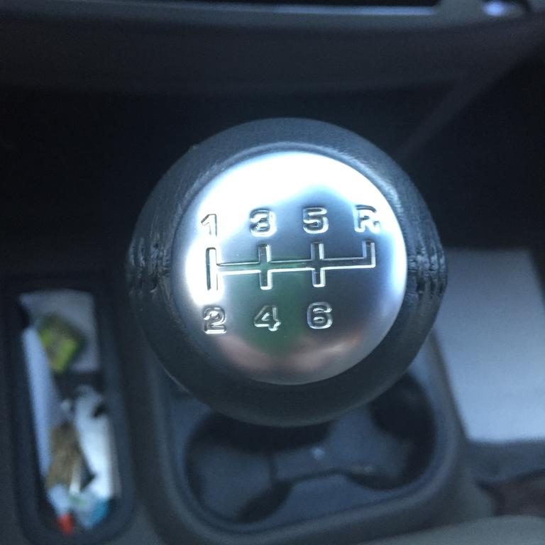

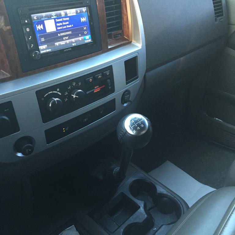

had to chase the threads with a M10x1.5 and on it went. looks and feels great! A lot nicer then the POS stock G56 knob. Even has a anti theft feature built in! Reverse is fifth!
