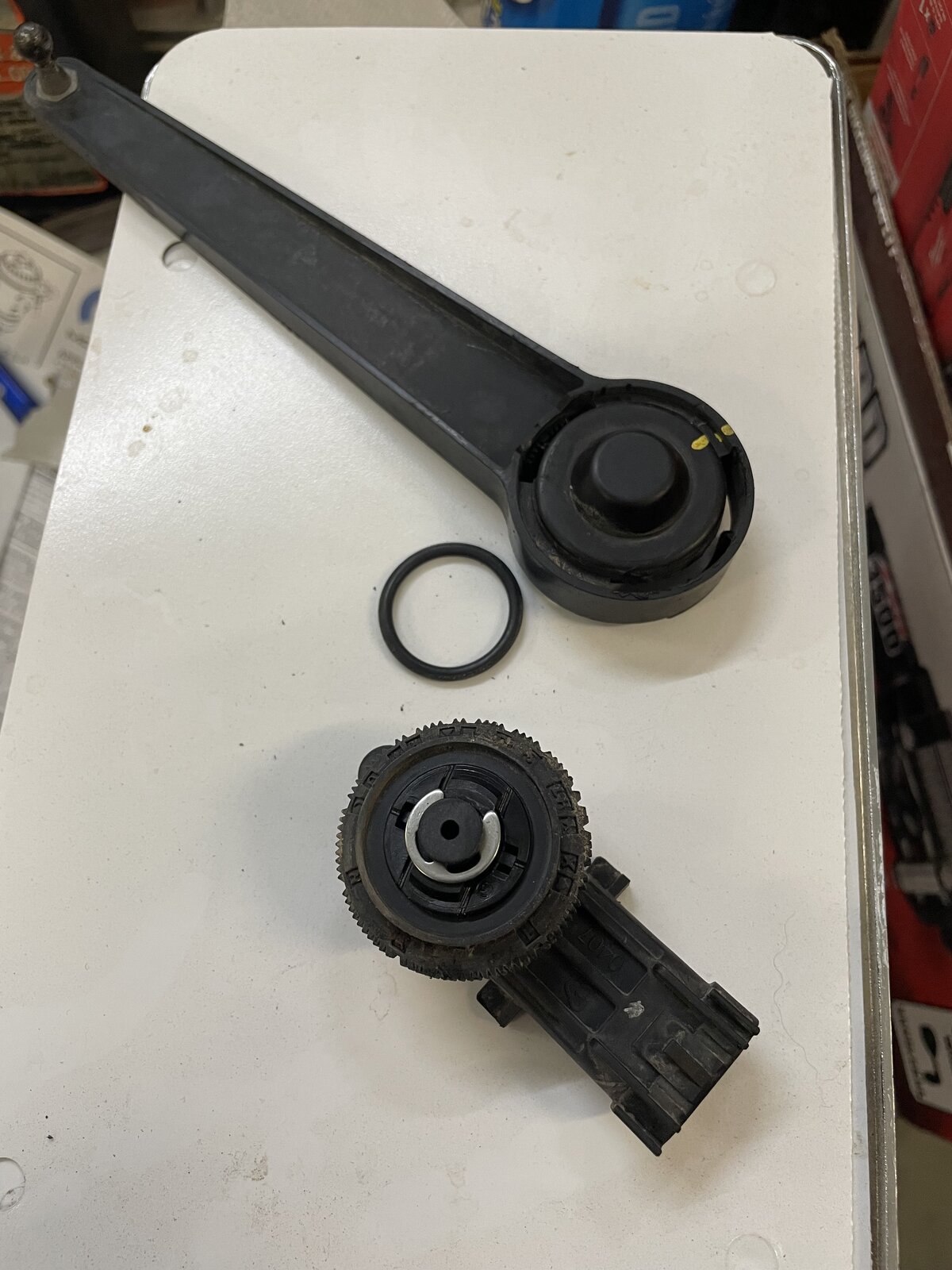

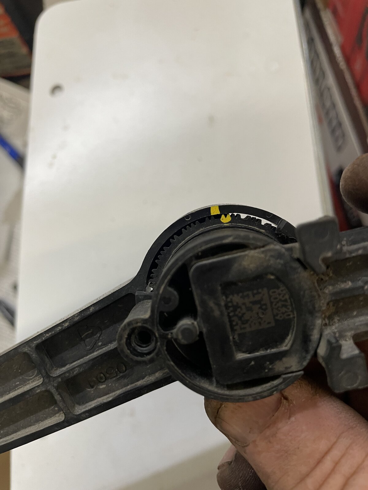

Turns out the sensor and arm can be “snapped” apart and re-clocked.
Match mark before you start so you can get back to original, or know how far you’ve moved it.
I’ll report back if any problems arise.
I’ve put about 3000 miles on truck with “adjusted” ride height sensors. There must be some minimum factory air pressure or something going on. “Normal” height is a good bit lower, “alternate” height is not much different than alternate before adjustment. ‍♂️
