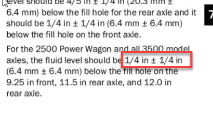

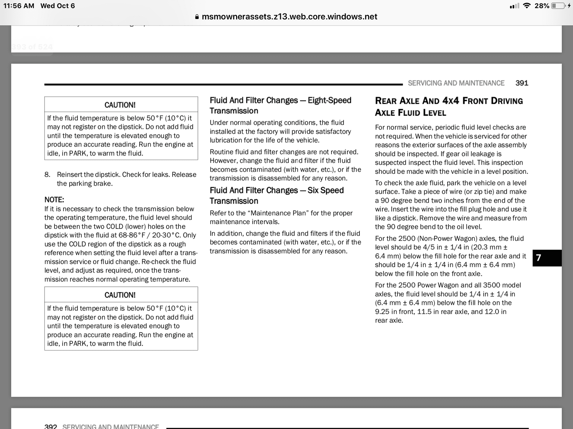

Yeah, My 04 didn't hold that much either, glad I had a couple extra quarts of Sever Gear laying around since both axles took about 1/2 quart more than my previous truck did.:D.. I think I am not going to worry about the front axle "not being" 1/4" below, nothing even turning in there except the side gears..,, Leave it to AAM to change a long standing common procedure for transmissions and axles and replace it with a "coat hanger" needed.. I assume it wont leak due to the fill level being slightly higher... or should I waste my time drawing some out..:cool:
EDIT: any downside of leaving it "level" with the hole?

My 2500 has an etching on the diff cover that says "fill level" (or similar), it is about 3/4" below the fill plug.
1/4"-1/2" below the fill hole is pretty standard. I have seen several trucks in the shop brought in for pinion seal leaks. We would pull the plug and find the fluid level at the hole or fluid running out. We'd pull some out until it was at the proper level below the hole, clean the diff off, and send them on their way. I don't recall any of them coming back due to a pinion seal leak.

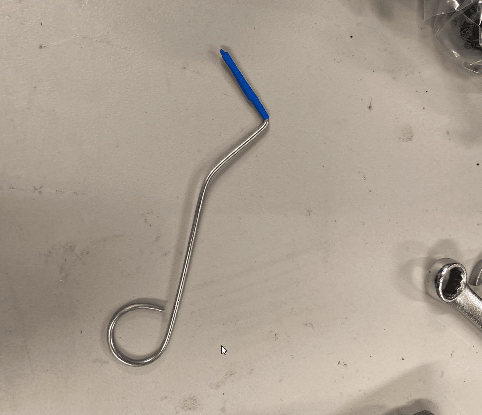

Made this today.... (based on the FSM excerpt about using a coat hanger or Zip-Tie)... Interesting, I put her down (off the lift) and after sitting, both axles were ~ 1/4" below the fill hole........... so perfect! :D:D
So based on my "checking and confirmation study", I think I will start selling them... $2.49.. , but wait.... I'll send ya a second one free!!!! (just pay separate shipping and handling)..
Great idea but spec is good letting it run out the hole.
