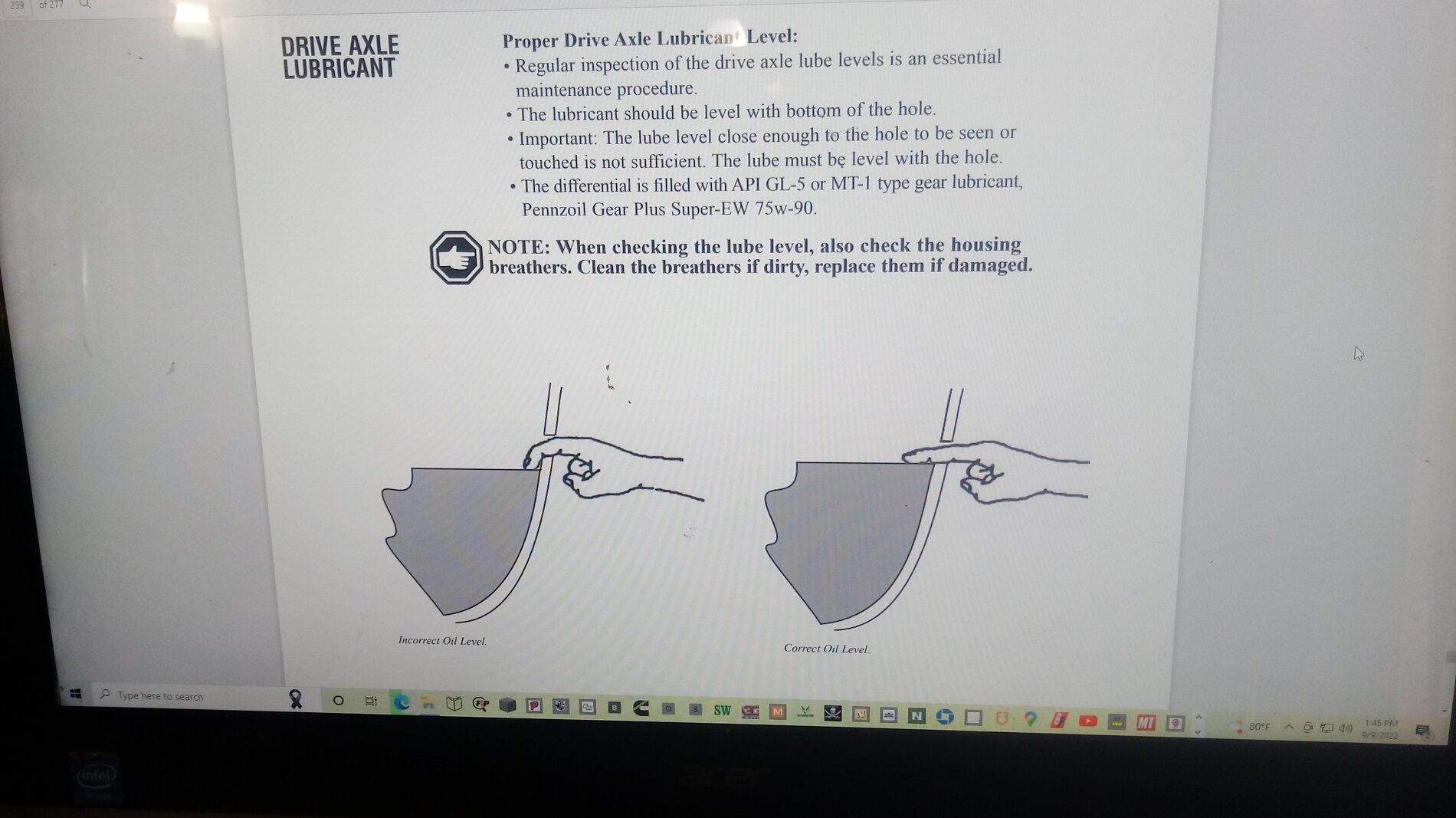

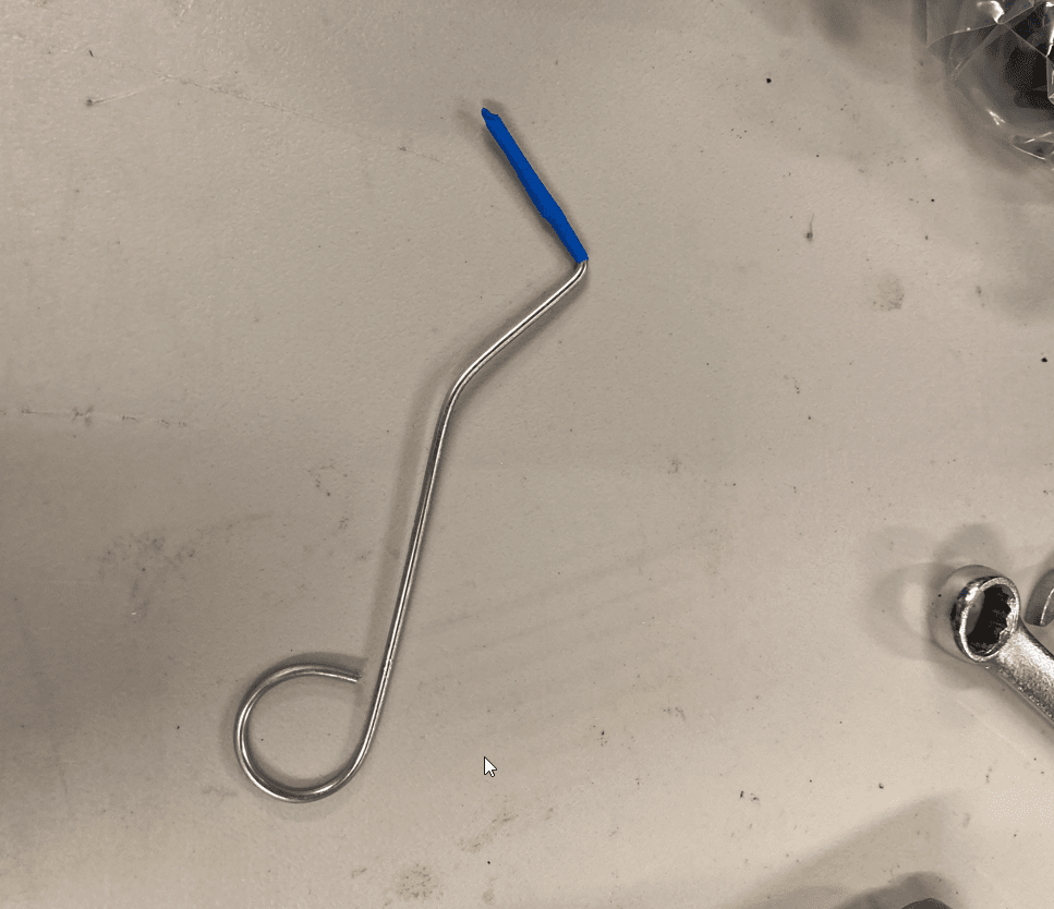

Made this today.... (based on the FSM excerpt about using a coat hanger or Zip-Tie)... Interesting, I put her down (off the lift) and after sitting, both axles were ~ 1/4" below the fill hole........... so perfect! :D:D
So based on my "checking and confirmation study", I think I will start selling them... $2.49.. , but wait.... I'll send ya a second one free!!!! (just pay separate shipping and handling)..
I like the tool and may "borrow" your design! I'll give it back when I'm done..;)

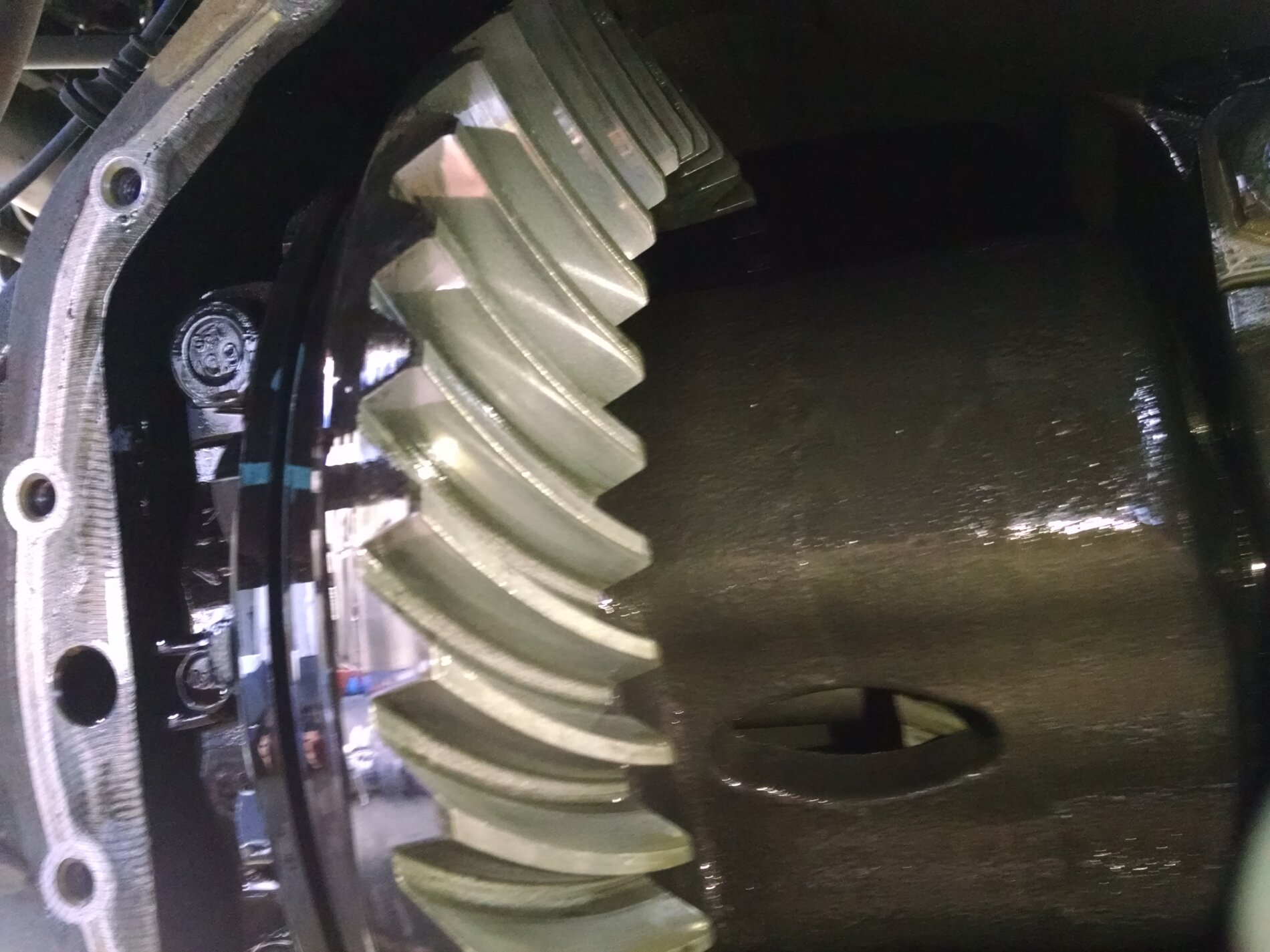

I took my RAM to Ron's Garage for the first diff fluid changes!! Things looked good and Amsoil was installed!!!! Of course you already knew what gear oil was going in! And yes that ring gear had 41 teeth!!! With 12 on the pinion!
Fill level presumes your truck is on level ground.
Yeah... I'm spoiled and my shop is level inside and can fit several of these trucks. :cool:
Best of luck on your service, if you have to, go to a level spot, lot and put a level or angle finder in the truck bed and determine where (how much tip angle) the truck needs to be to be "level" then duplicate with jack and stands in your driveway.

I agree and it drives me crazy:D I can't understand why Dodge/Ram makes it so complicated. The axle manufactures fill instructions are plain and simple and are used in multiple applications. For sure, the fill plug location is not changed for every application. They say fill the sucker to the bottom of the fill hole.
Some copy and paste info from Dana lubrication service manual.
Note: Dana mentions different application capacities depending on install angles. Not that the fill plug location is changed to accommodate the application.
"Remove the filler hole plug from the side of the carrier and fill the axle with the approved lubricant until level with the bottom of the hole"
"Always use the filler hole as the final reference. If lube is level with the bottom of the hole, the axle is properly filled."
"Note: Lube fill capacities are basic guidelines and will vary based on the angle the axle is installed in a particular chassis. Torque fill plug to 40–60 lbs. ft. (54–82 N•m).
