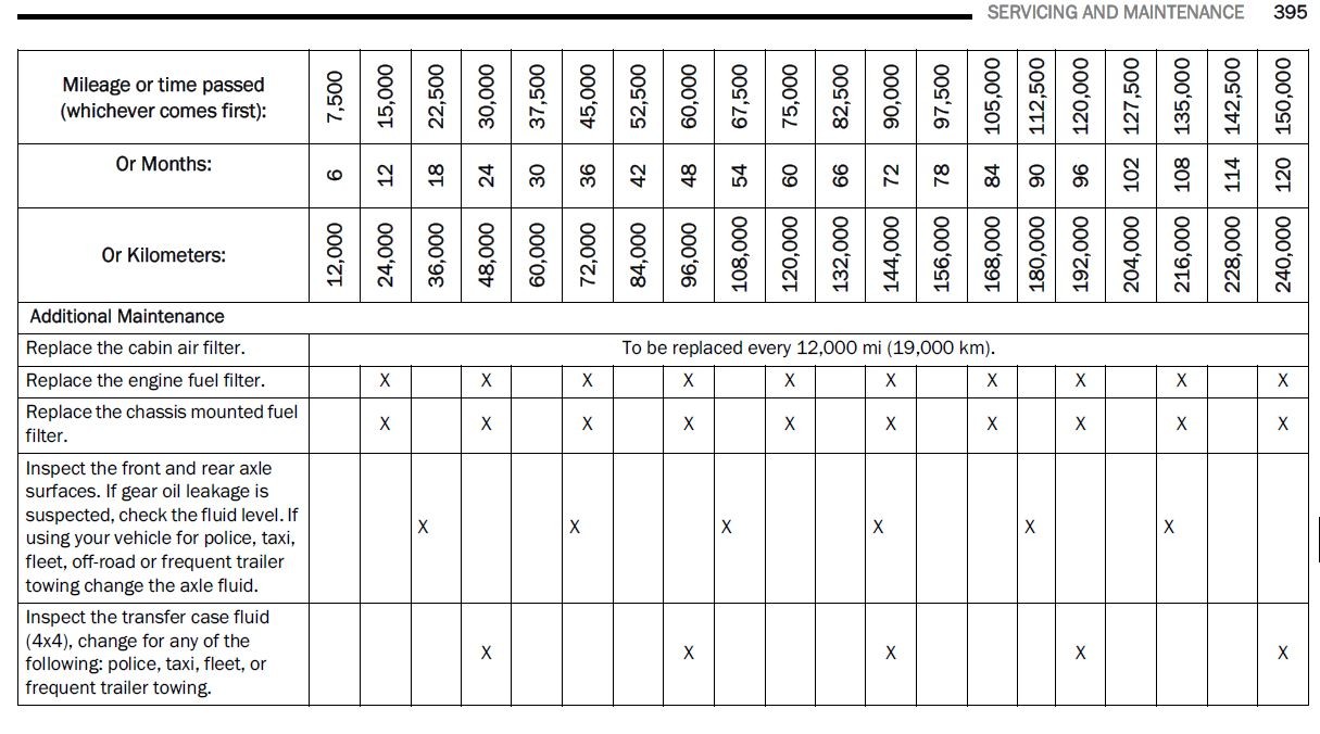

So I had my differential gear oil changed at 3000 miles to Amsoil severe duty . l haul heavy (3000) lbs in the summer months slide in truck camper. Now at 24 months and 20 k miles. When should this be changed again? Don’t forget my warranty
I have no leakage so am I severe duty. I suppose I am . So I will have it changed next fall 36 months about 27 k miles I should be fine I think.
What a waste of Ressources to throw that almost mint Oil away.. that's barely broken in.
As you can see in the schedule there is NO planned replacement for standard duty, not even at 240'000 Miles, it says inspect the OUTSIDE for leaks and check level IF it leaks - it's a Lifetime fill, not even the level is checked on a regular basis. So on a standard truck, that diff won't be opened for 20 years or so.
Your truck isn't severe duty if it comes to the axle for carrying a small Camper for 2 Months a year - ask @Cummins12V98 what severe duty means.
