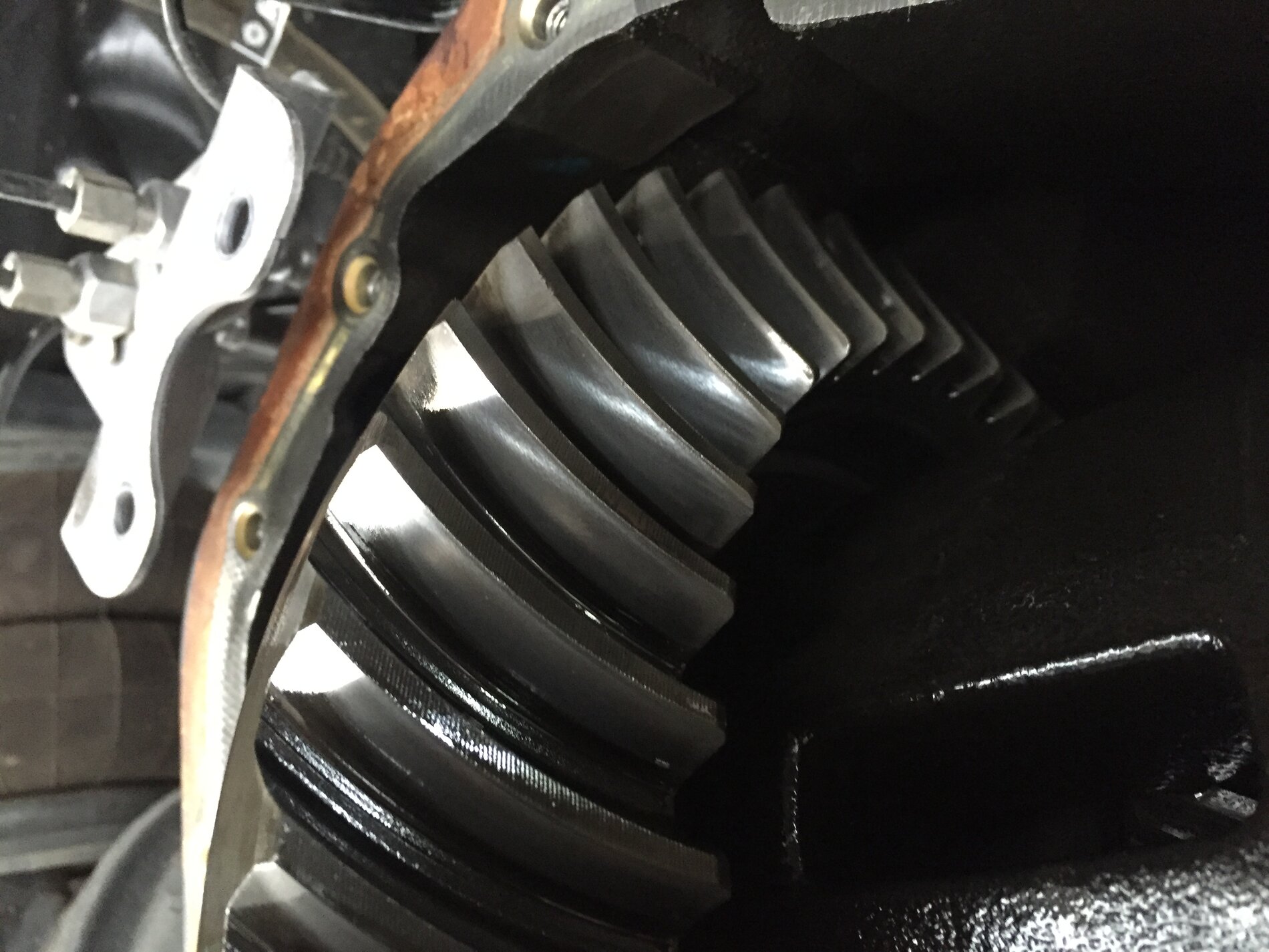

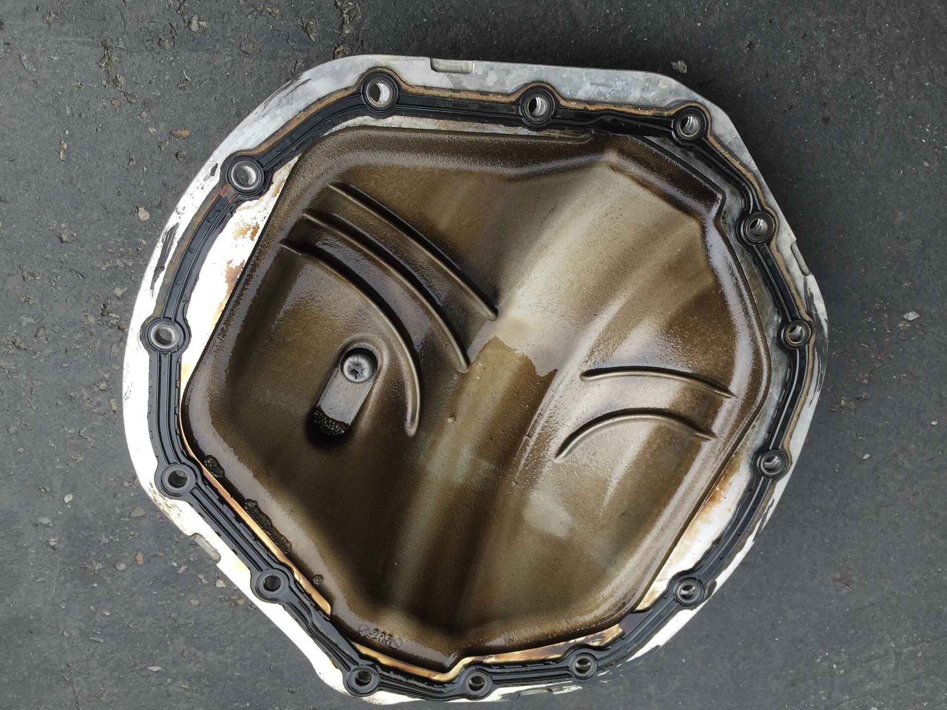

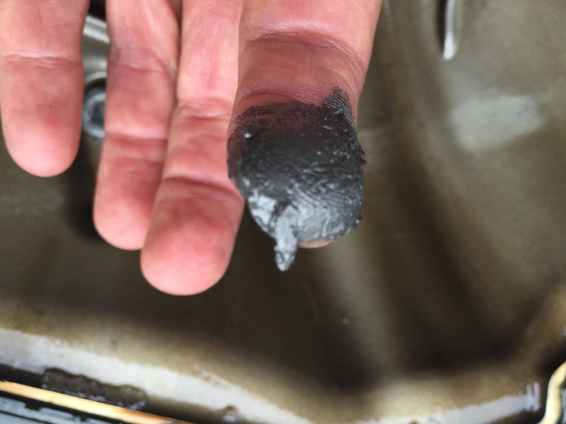

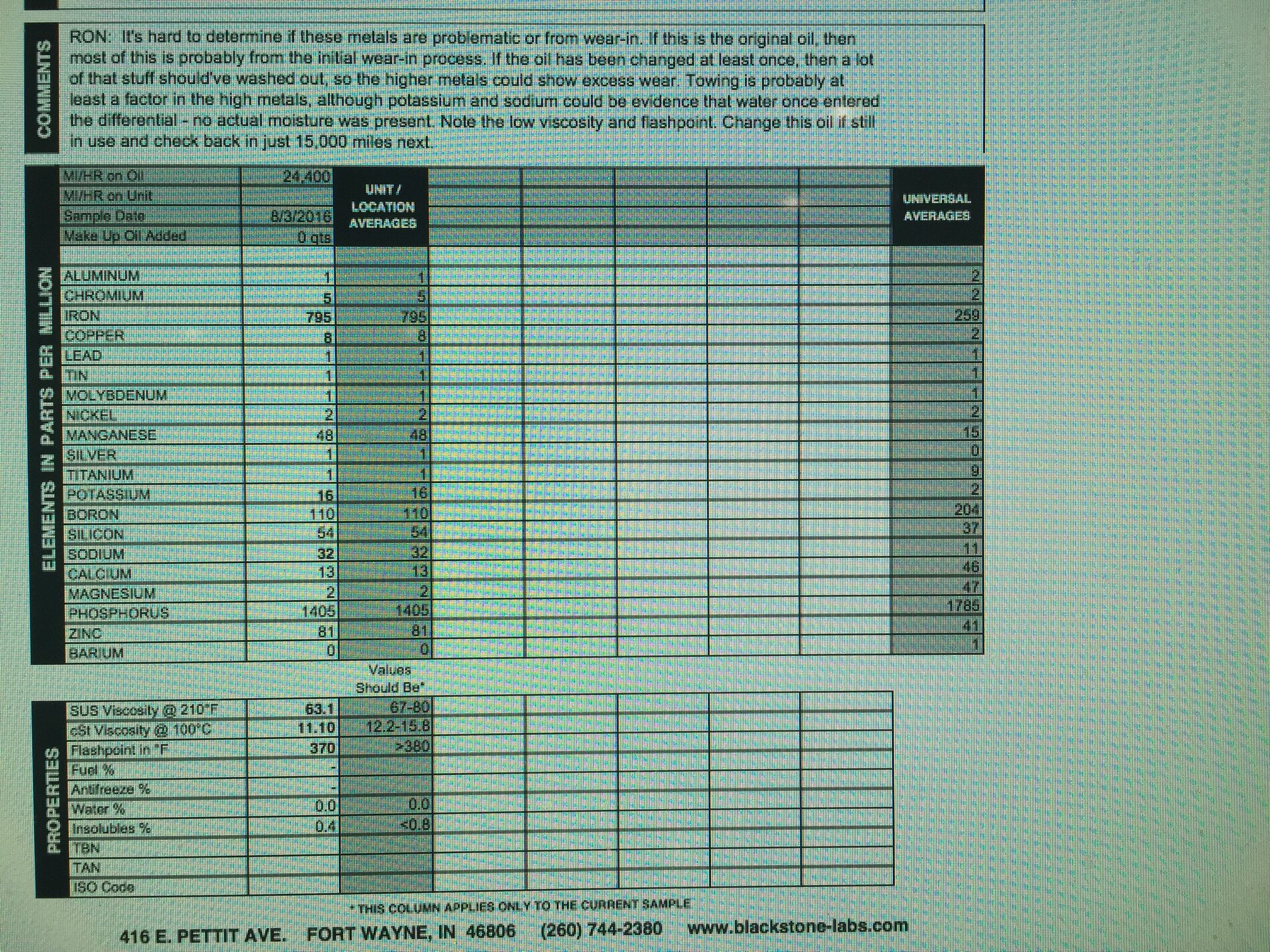

I read my schedule and I thought it was 24k severe duty but the reality was it's 24,250 kilometers and 15k. So I really screwed up! I was on a trip with a few thousand miles to home and noticed when taking off and turning it felt like it does with 4wd on turning on pavement. Why I did not do an early change I have no idea!!!
Bottom line this lube was TOAST at 24,000 miles per report. Good share of the miles were towing a combined 34k.
Since that change I have been doing 20-25k and the lube comes out looking good and the cover is no where as dark. AMZ/OIL 75-110 Severe

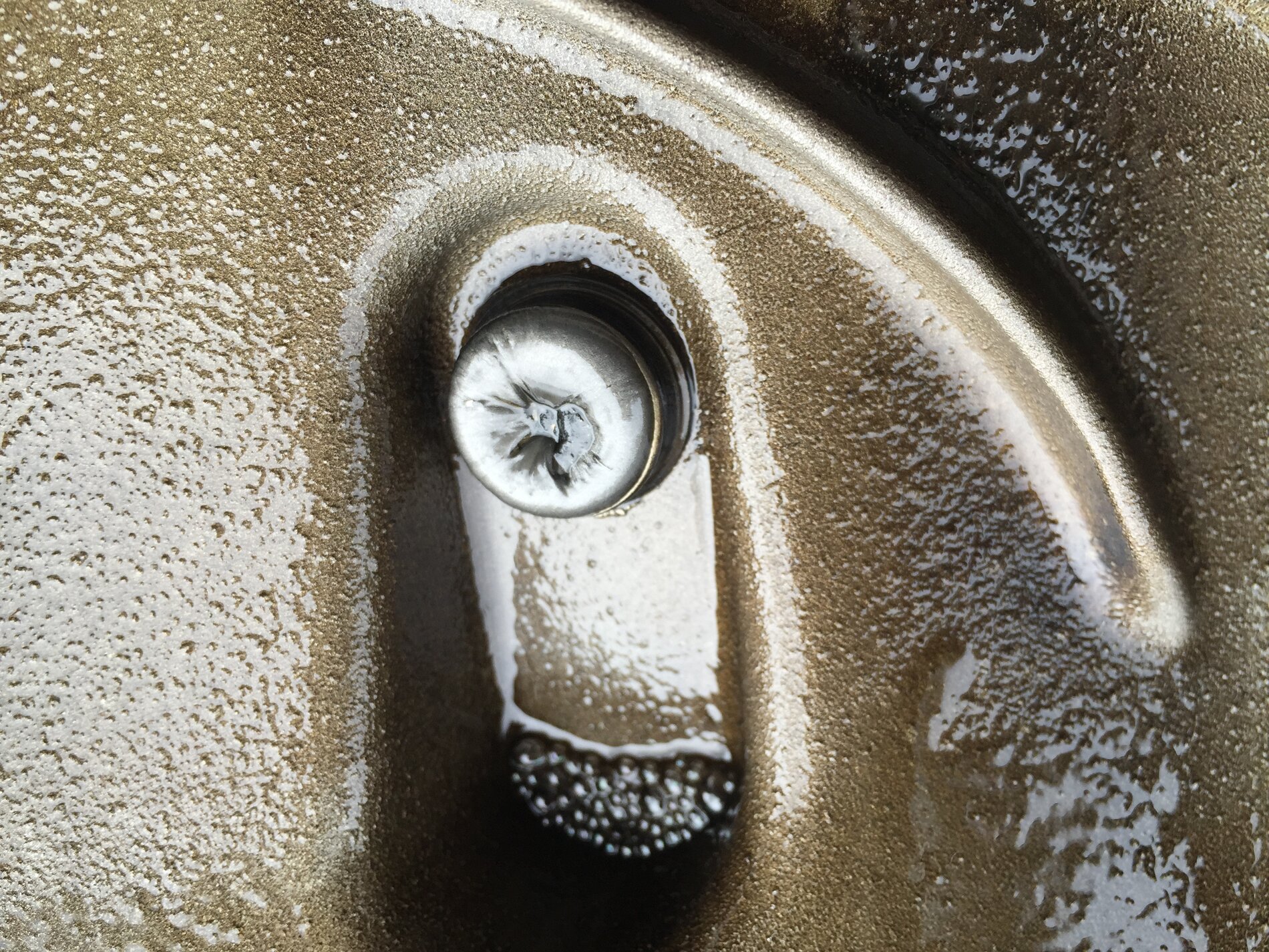

View attachment 139064 View attachment 139065 View attachment 139066 View attachment 139067 View attachment 139068
Luckily the 19+ OEM lube is much better than the previous OEM lube. I still dumped it early, but it wasn’t nearly as bad.
The first change always looks horrible from the gears break-in period.
