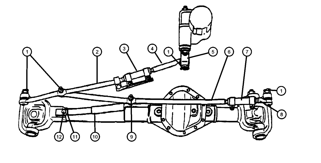

Thanks for replies. So trying to create a list of needed parts using the below picture I come up with the following which I by no means say is correct:
#2-drag link (05086144AB) DORMAN TC81044XL
#4-tie rod that goes to pitman arm (05086143AA)? DORMAN TI96031RD
#6-tie rod outer (05086145AA) DORMAN TT81074XL
#8-tie rod outer from left (05086146AB) DORMAN T3625RD
Dorman description refers to these parts as "1st design" which I'm guessing means Y. Should I get adjusting sleeves or any other components that I'm missing.
Thanks, Sven
Thanks, Sven
looks like #4 should be DORMAN T3625XL which says "1st design" not "Superior Design"
The T-upgrade comes with two different draglink heads to fit the old style 4-bolt steering gear/pitman or the new 6-bolt box.
But if you are happy with yours then keep it, there's nothing wrong with it if it serves your needs just good.
First design is correct.
