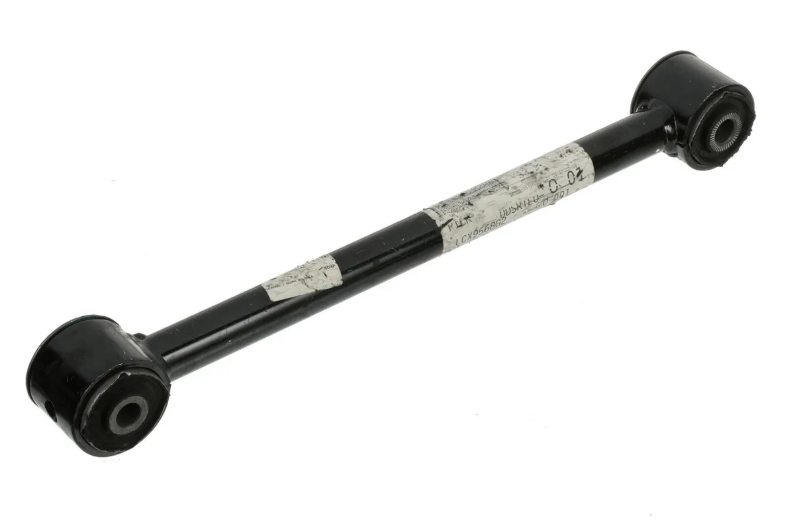

I didn't know Mopar upgraded the original control arms. How were these upgraded?
The older trucks like mine, the lower arms were sheet metal like the uppers.
When I needed replacement the original design was already phased out and replaced with the tubular ones shown in the picture.
