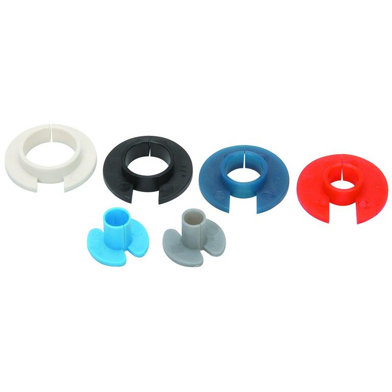

Also you can get a set of tools at harbor freight for about $5. Yeah I know, I am not a fan of harbor freight myself but even they should have a hard time screwing these up. You could probably go high class for $20 (as long as you avoid Snap-on).

Thanks for the replies guys. I will give it a go this weekend. I have to do something with it leaking inside the cab. I know antifreeze is not good on the carpet. What tools are you talking about that I will need from Harbor Freight? I usually dont shop there unless I am getting something that I will hardly use or only use once. Other wise I try to buy Craftsman. I think the dash has been replaced because it is not cracked and looks fairly new.

These are the cheap ones.
Nicer ones are at the end of a pair of plier style handles. These connectors are used a lot on newer vehicles so they are nice to have on hand.
Just about any part store should have something similar.
http://www.harborfreight.com/6-piece-fuel-line-and-a-c-quick-disconnect-tool-97576.html
