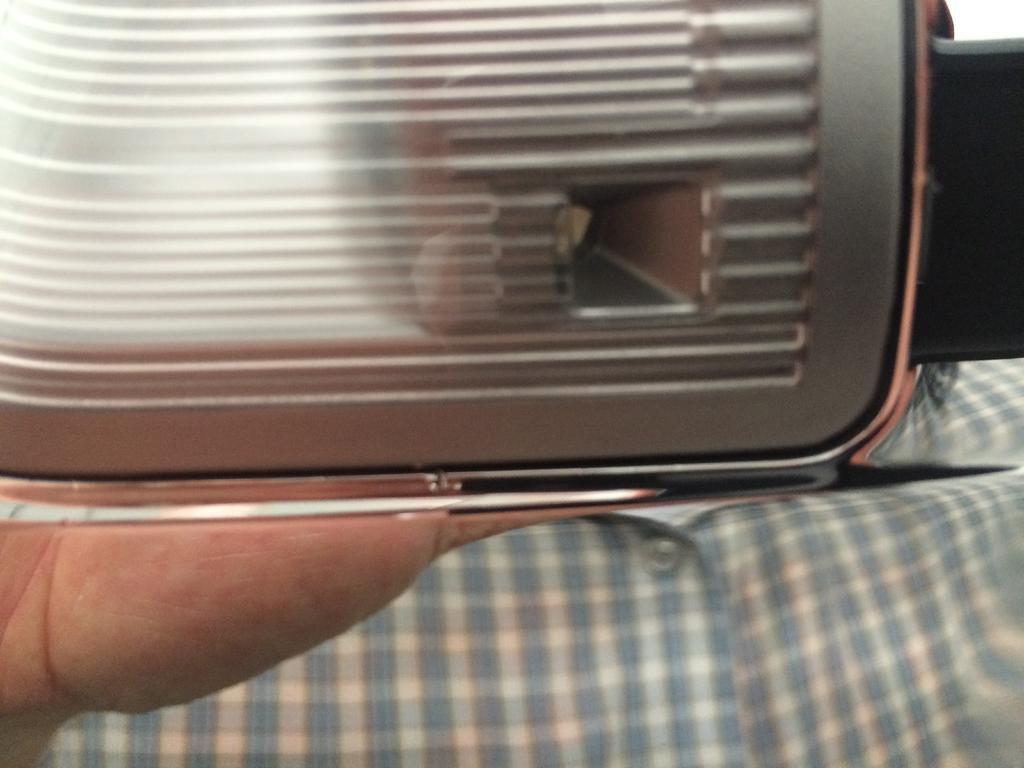

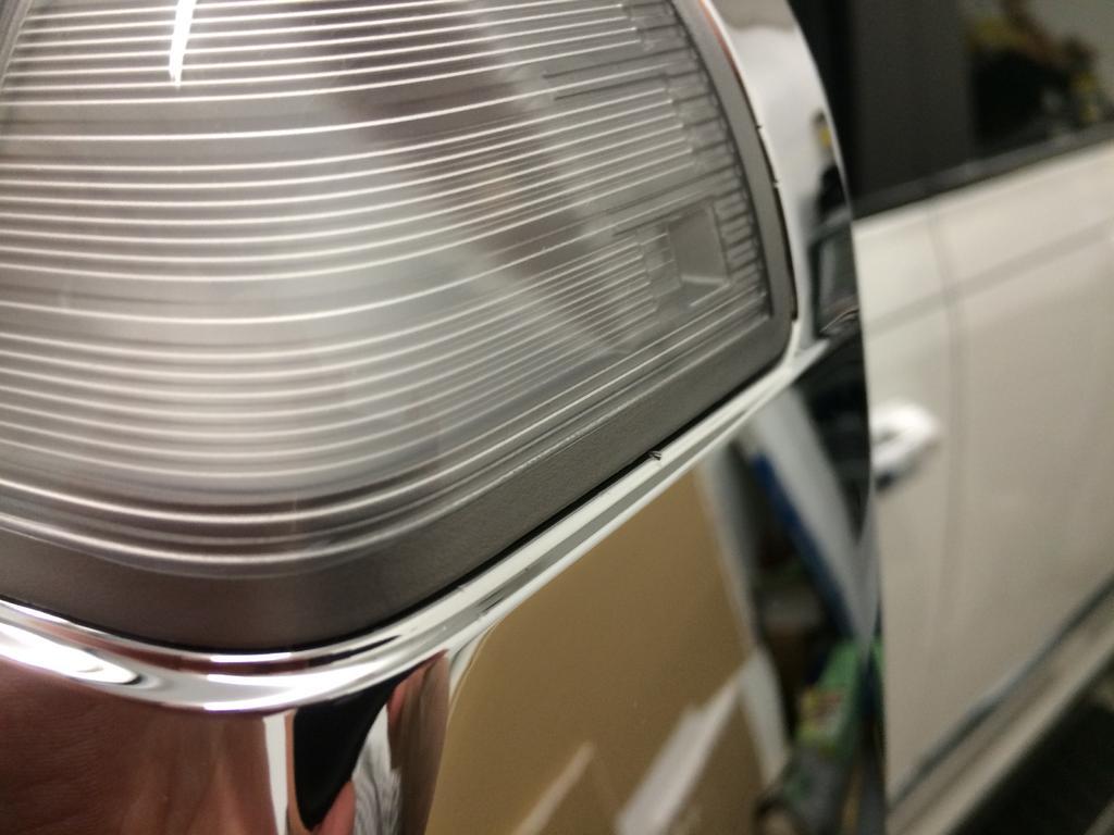

Well the dealer changed mine out at no charge. Too bad they scratched the chrome mirror while trying to remove the old lamp assembly while they were doing it. I should have just done it myself. Now I have to decide if I will make them replace the whole mirror or live with scratch. Ken Irwin
