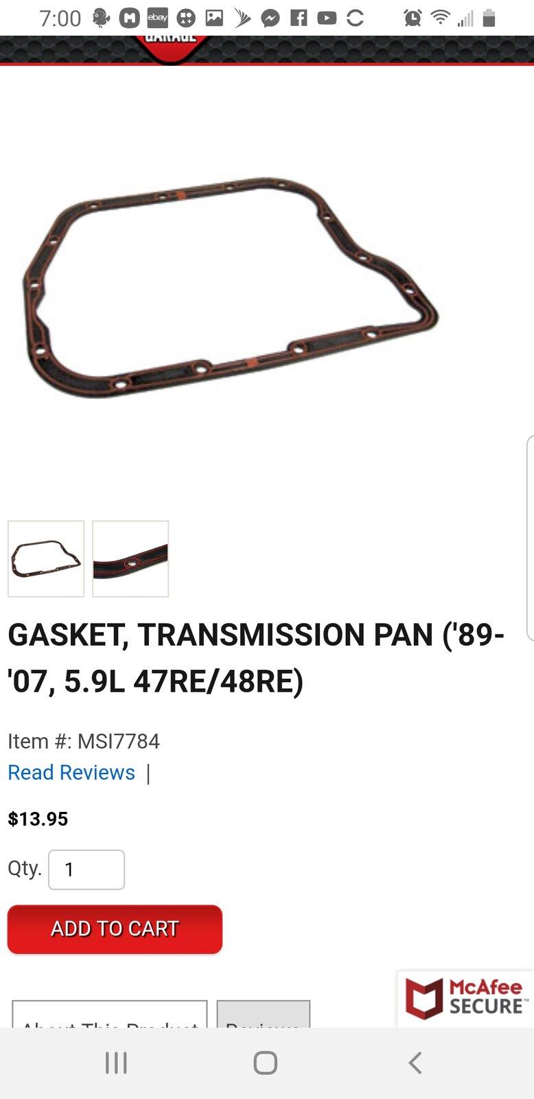

Anybody find they have to use a greater torque setting then the factory recommended 13ftlbs to get it leak free with these newer design reusable plastic (I think that's what they're made of, maybe some composite material) transmission pan gaskets? Twice now I've had to go to close to 20 ft lbs before they stopped leaking. Anybody see a problem with that higher torque?
EDIT: this is with a aftermarket aluminum deep pan.
