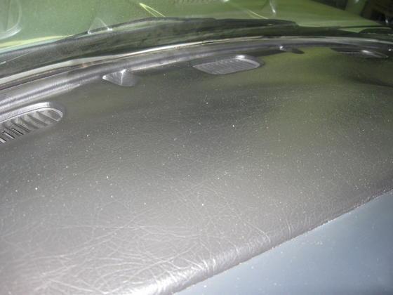

I just replaced the dash on my 2001 with dash from LMCtruck. The fit and finish are as good as the OEM. It has all the gussets and holes just like the original . They have them for 200. 00 plus shipping in 3 colors. "Note" if you have the Agate interior the dark gray they sell is a shade lighter the stock.

Thought I might add the painting process.
First I used wax and grease remover with paper towels
Second I used Tack rags to remove dust etc.
Third I used Sem 38363
The Sem plastic prep softens the plastic and you apply the paint dry while the Sem is still wet. The Sem helps absorb the paint into the plastic for better adhesion. As for the statement "apply paint dry" I just held the spray can far enough away so the paint basically was already dry when it hit the wet Sem.
Edit:
Forgot to add after the initial coat flashed I just painted as normal for the desired finish
Hope this helps
