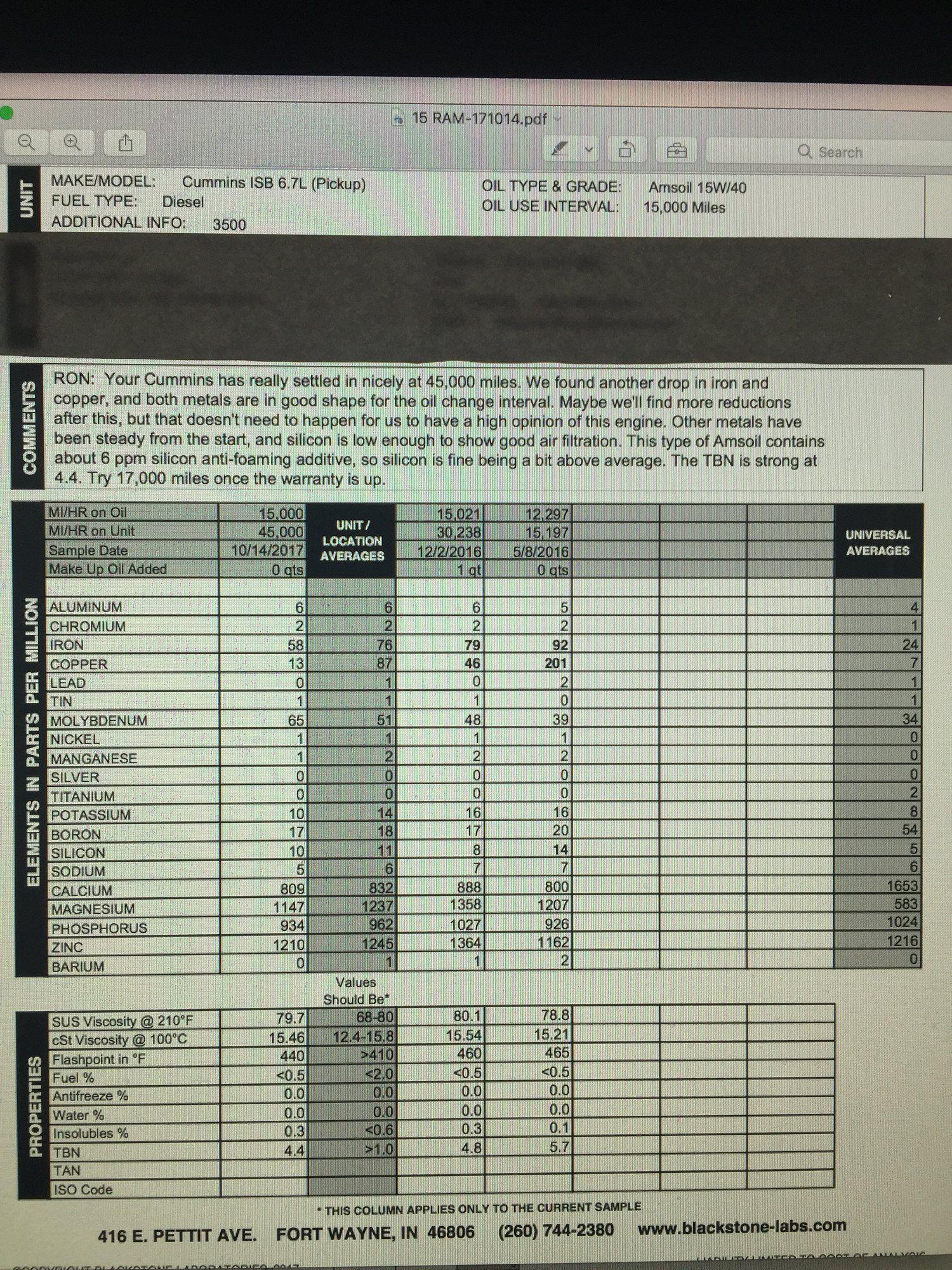

I will be changing again at 60k next month and will post my results.
TBN is obviously solid enough to go 17k as Blackstone recommends.

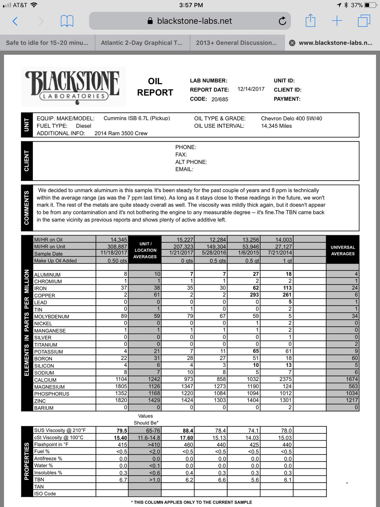

The OEM recommendations are based on average use, I'm willing to bet on the same oil with another truck, it would show poorer results. I have only used OEM, or what the dealer uses. Blackstone sampled at one time early in the trucks life, which showed it to be OK, after 5K miles. But I could have gone further I suppose, but why chance it. Its good that you have gotten good results, but you have to test the oil to be sure.
Some of you guys with these short oil change intervals spend more time under your truck then behind the wheel. Why would the manufacturer provide a 15000 mile oil change if it would lead to engine damage (thus expensive warranty repairs).
I'll maintain mine as directed by Cummins. I think they may just have a tad bit better insight on this. Besides my shed is full enough without having to stockpile cases of motor oil.
