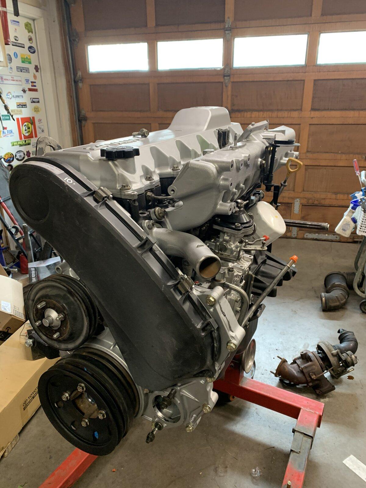

Yes I do have somewhat rare diesel Toyotas. They are pretty sweet little motors; direct injection overhead cam 24-valve 4.2 inline six. Smooooooth and quiet. Powerful but not a 6BT haha.
Problem with Toyotas is that they are so reliable people abuse them and by the time I get my hands on them they are a little long in the tooth.
You might post up a thread on these. Some of us have a soft spot for all Diesels ... and some like me have seen too much Diesel carnage. :)
