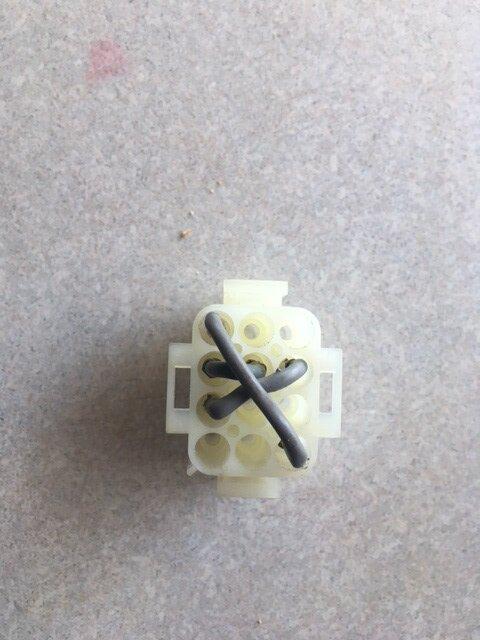

While searching for a wiring diagram for the DTT Smart Controller I came across a jumper plug in my center console I completely forgot about. It is used if the controller is in question of a problem. You simply unplug the controller and install this jumper plug. I didn't see the relay that was there but maybe it's plugged into a unused socket in the PDC. It was so long ago I can't remember.
Here's a picture of the jumper plug

Anchorage Alaska. Thanks David. Just what I needed. Sounds like TDR comes thru again. And thanks to you Boeing Diesel. I thought my Dodge Cummins was going to the boneyard. Still like this truck 22 years later and 168 k
The white cube essentially takes the smart controller out of the system . With out the torque convertor being locked up the exhaust brake can’t work of course. But it should make the truck appear to be stock for the most part so that code scanner/diagnostic tester should see a stock transmission which is a good thing to know
