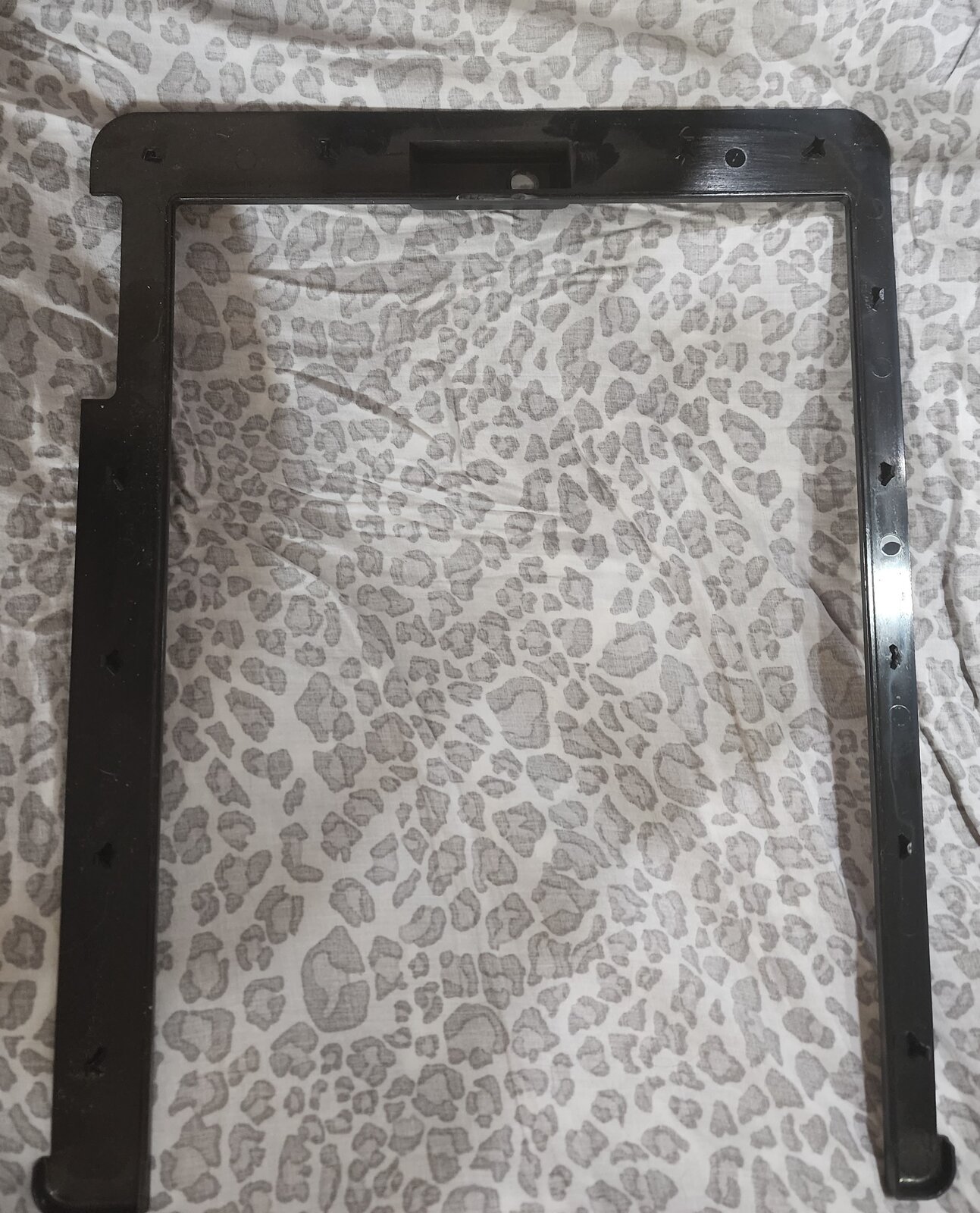

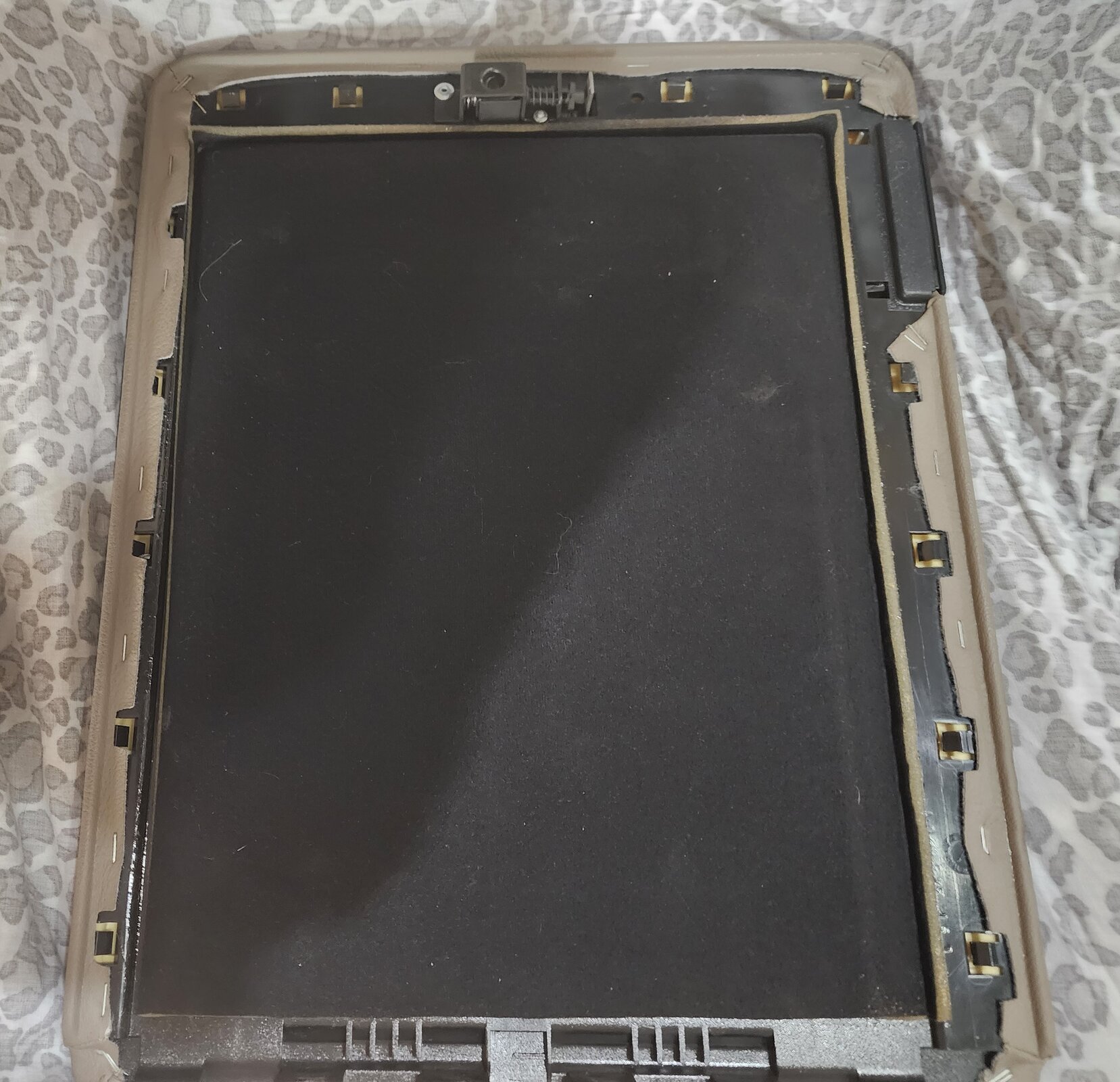

I was able to separate the plastic bezel from under the lid pretty easily. I only broke one of the lock tabs, on a corner. That was where I was getting impatient. In this hot and arid climate, breaking only one is a win. If necessary, I can replace it with a short, flathead sheet metal screw and some careful countersinking.
The vinyl cover upholstery is held in with staples and looks simple to remove. Replacement pre-sewn vinyl covers in almost-good colors are available from an eBay seller for $30 to $46.
Good job on only breaking one! I treat the old cover as sacrificial and just cut them. The eBay covers are not bad at all. One trick I use when replacing these, once you get the cover off you will see one of the lame defects Dodge build into the design, the egg crate pattern the plastic is made of cuts into the foam cushion, just go to walmart/target and get a thin plastic kitchen cutting board trim it to fit and install it between the lid and the foam cushion as this will prevent the foam from getting cut into bits and leaving a "elbow" dent in your newly refinished lid.
The eBay cover is on order. I had found a YouTube video that demonstrated the hard plastic egg crate that promotes the damage to the foam and vinyl cover. The thin cutting board is a good idea. I was thinking of masonite, but the cutting board material will just shrug off getting wet. I'll also need to find some fairly thin and stiff foam to replace the original. Any thoughts on that?
