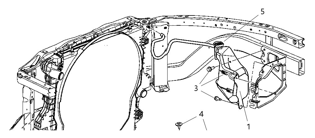

Also adding a drawing from the parts book of the '04½ to '09 coolant bottle. The bracket it mounts to appears to be the same as the one in my '03. Gotta find a later model to look at and take pics. Just really want that overflow bottle out of the way up front and this is the opportunity to do that.
#1 is the bottle, #3 are the screws, #5 is the cap.

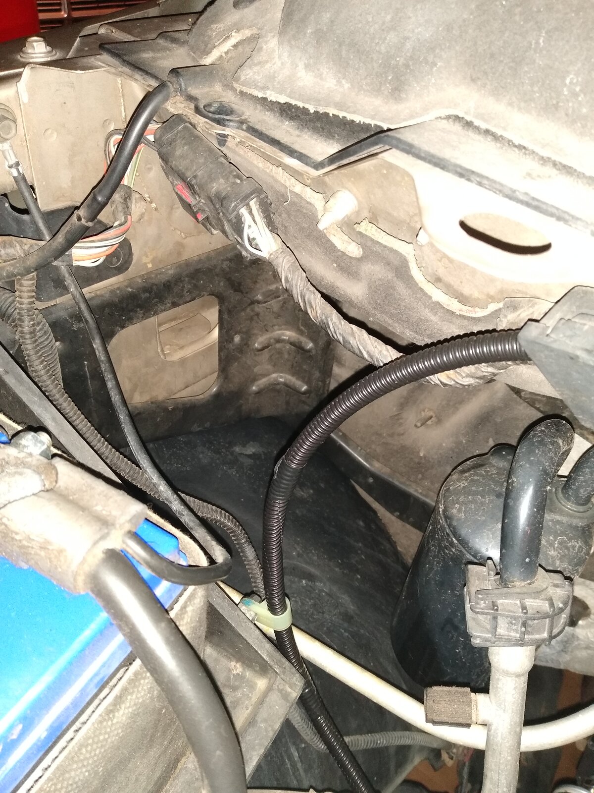

After laying underneath looking for the leak (have not spotted it but the shroud blocks the lower part of the radiator) I realize that the coolant overflow bottle actually forms part of the left side of the shroud and if removed, the fan blades would be throwing air off the tips, so changing out the bottle for the later type is not an option from what I see. I ordered a new GPD radiator and Gates turbo hose and boots for all the pipe connectors. Also discovered that the Gates green belt is on national backorder and even Genos has a note to that effect in the listing online. I stumbled into the only Gates K081264HD (Fleetrunner Micro-V) in the O'Reilly's parts system at a location an hours drive from me. Went this evening and picked it up. O'Reilly's is a Gates dealer. Just not to be found anywhere.
