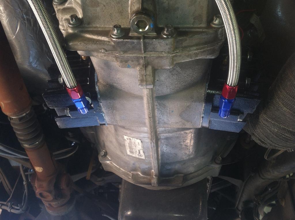

Here's a couple of pics of the transmission before install. The FastCoolers and my start for a custom external cooler can be seen. For now the hose just connects together for keeping dirt out. Later this will go to an external cooler, pump, and filter to keep the transmission cool. A project for another day. #ad

Mike, won't the exhaust be in the way of that cooler on the passenger side, mine was and I shaved down that portion of the cooler as not to interfere with it. Then I wrapped the Exhaust to help from transferring heat. If you look closely at the coolers, you'll see what I described.
Mike, won't the exhaust be in the way of that cooler on the passenger side....
It clears, but not by much. When I first put these in, I had to make the bolts about 1/8" shorter on that side to get it in, but this time I used new proper bolts. Probably part of the reason I had a slight weepage was inability to get a good seal doing it in place with the fluid change. I'll be putting the cooler just forward of the fuel tank, at a slight angle, with an electric fan, pump, and filter housing. The thermostat will come on at 205, off at 185. That is what you see on the other side, in addition to the sender for the temperature gauge, just below the sight glass. I won't get around to completing that until later this year, maybe. Have to fabricate the custom mounting brackets and get it all in there. This is modeled loosely off your system.
BTW, what exhaust wrap did you use, and does it work well for you?
Got it on line a few years ago, I don't remember info anymore. But a standard exhaust wrap should work. Now that I don't need the coolers anymore, I'm going to remove them and have bungs welded onto the original PTO covers and install them.
