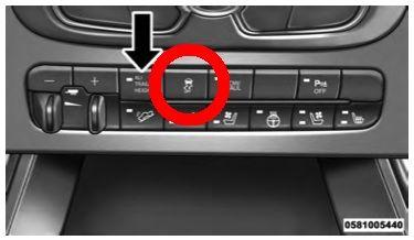

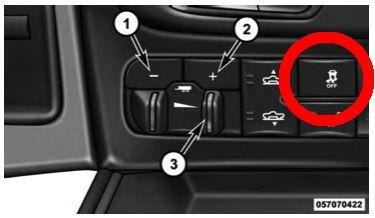

Mike,
The TCS (Traction Control System) is subset of the ESC (Electronic Stability Control) system.
The button to control the ESC is located in the row of switches below the uConnect system.
Here are a couple of pictures I captured from the owner's manual and should give a rough idea of what to look for. The button has an icon of a skidding vehicle with the word "OFF" below the icon. I circled the examples in red.
The ESC has three modes...
ON (the default): Enhanced vehicle stability, engine power reduction, traction control, and torque management are all enabled.
Partial OFF: Enhanced vehicle stability is reduced, engine power reduction is disabled, and traction control is disabled. Torque management is still enabled.
Full OFF: All features are disabled.
To select Partial OFF, momentarily press the ESC button at any time.
To select Full OFF, press and hold the ESC button for 5 seconds WITH THE VEHICLE STOPPED and the engine running.
NOTE: Full OFF mode will revert to Partial OFF mode when the vehicle speed reaches 40 mph. When the vehicle speed drops below 35 mph, Full OFF mode will reenable.
See the ESC section of your owner's manual for more details.

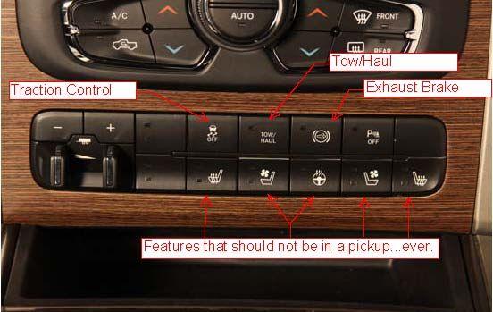

Exhaust brake should be in the same row of buttons as the traction control. It will literally look like a "Fart" button.
Your dash may or may not look like that, but the icons on the buttons are an internationally universal standard. Thank you McDondalds. :rolleyes:
