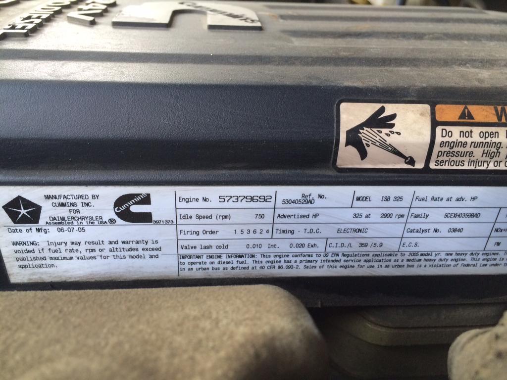

One other suggestion . On the side of the plastic shroud that covers the valvecover there is a sticker on there see if it says CARB approved ? I think the ETH code was for the pre 600 motor or pre 04.5 . I still have my sticker I will look after I get home from church
This is the only sticker on my valve cover. It just says "US EPA", nothing about California or OBDII.
It should pass with the 2monitors out of 3 run
That changed May 4...it is now all three: Comprehensive, Fuel and Misfire for diesels under 14,000GVWR up to 2006. Later trucks can have one not ready, typically I think that will be the EVAP? I think I won't be the only one scratching their head on this one. :(
